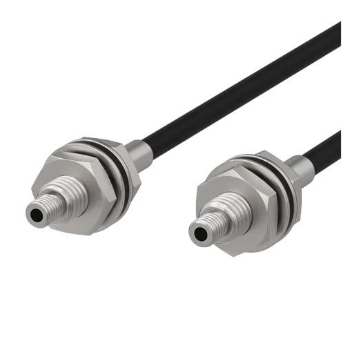

Fiber Optic Units
Autonics' new fiber optic units are available in nine different head types and seven different cable types, allowing for flexibility in fiber optics system design. Cable types range from heat-resistant to vacuum-resistant to fully waterproof models, and can be configured with L-shaped, cylindrical, thread, perpendicular, and other types of connections. All cables are highly flexible, making it possible to use them in virtually any environment. Available in one or two-meter lengths, these units will fit virtually any machine without the need to build units in-house.

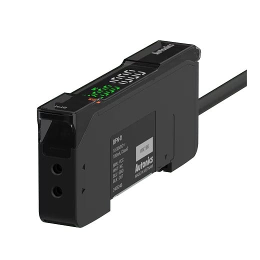

Autonics’ BFN series amplifiers are available in two-line white/green FND display standard or high-performance models and volume adjustable models
Autonics’ BFN series amplifiers are available in two-line white/green FND display standard or high-performance models and volume adjustable models. Image used courtesy of Autonics
BFN Series Fiber Optic Amplifiers
For long fiber runs, there will be some signal loss. This is no different than running long signal wires. To combat this, inline amplifiers, such as Autonics’ new BFN series can be added to a system to minimize losses and maintain system speeds. The BFN series maintains steady detection and can respond in as quickly as 25 µs, depending on the specific model.
Each amplifier is volume adjustable, meaning it can be adapted to the environment and the specific light signals that will be interpreted. Some models have a dual display, while others have a simple LED for output. Up to 30 amplifiers can be linked together via the side ports and then mounted via DIN rail, making it easy to install and organize multiple fiber optic signals into one comprehensive unit.

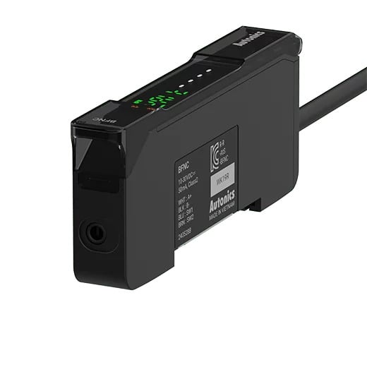

Autonics’ BFNC fiber optic amplifier communication converters feature support for Modbus RTU, EtherCAT, and CC-Link
Autonics’ BFNC fiber optic amplifier communication converters feature support for Modbus RTU, EtherCAT, and CC-Link. Image used courtesy of Autonics
BFNC Series Amplifier Communication Converters
The new BFNC series is both a fiber optics amplifier and a communication converter for converting fiber optic data into several other standard industrial protocols. Fiber optics data can be converted into Modbus RTU, EtherCAT, or CC-Link protocols for integration into larger automation systems, PLCs, and other such hardware. Multiple units (up to 30, depending on the models) can be linked together via a connection on the side.
