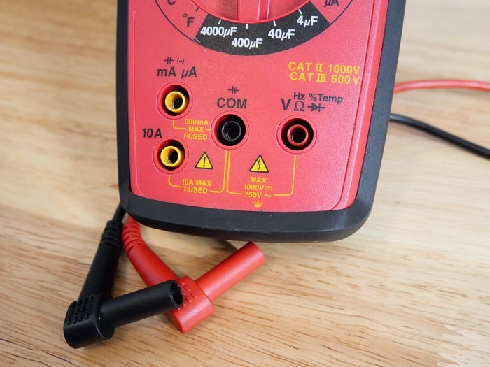

1. Voltage is not a single quantity, but a difference between two distinct values
It’s easy enough to ask, “what is the voltage at this point in the circuit?” And indeed, if someone poses such a question, you could assume that they mean with respect to the main neutral or to the negative side of the battery or power supply. But the concept itself is very important: we cannot simply have a voltage at some point in a circuit.
Failures always come from the wrong amount of current at a place in a circuit. Perhaps a broken wire means zero current. Or an overheating issue causes too much current. If we wish to locate the problem, we must be able to distinguish between the terms “voltage at a point in a circuit” (again, with the assumed ground/neutral reference) and the term “voltage across a device in the circuit.”
The main point: you need to be sure about where the multimeter’s black COM lead should be placed.
 Figure 1. Two test leads are critical to measuring voltage, unlike pressure measurements, to which voltage is often equated.
