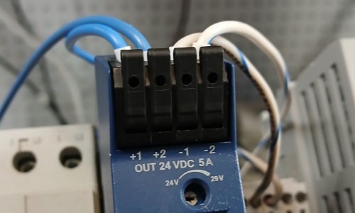

Redundant Output Terminals
Output terminals are usually marked with (+) and (-) to indicate polarity. Some supplies have one of each. These can connect to terminal blocks with jumpers to further distribute the power.
Some supplies have only a second (-) terminal, which can link to a nearby power supply to form a common ground, necessary for communication.
Having a second (+) and (-) can place multiple supplies in parallel to provide more power or redundancy in case of a failure of one of the supplies.
 Figure 3. Two sets of output terminals allow the supply to be placed in a parallel configuration.

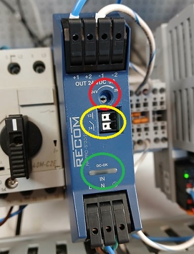

Operating Status Contacts
A set of contacts closes while the supply is active. If the input fails or the output draws too much power (a possible short-circuit or overload), the contact will open, and that signal can be sent to a control system.
Voltage Adjustment
A small screw terminal allows the user to adjust the output voltage. A few cautions:
First, only adjust this while measuring the voltage when fully loaded (all relevant output devices energized). If it is adjusted when unloaded, it will drop as more devices turn on.
Second, the adjustment does not compensate for a failing supply. If the voltage is dropping over time, examine for wiring problems or consider replacing the power supply; do not simply adjust the output over and over.
Indicator LEDs
Most supplies have only a single LED that indicates proper working status. However, some supplies use a series of LEDs like a bar graph to indicate the power consumption at a quick glance, saving time for the technician who no longer needs to measure the current to see a rough snapshot of the I/O.
 Figure 4. This power supply has an output status contact (yellow), status LED (green), and voltage adjustment (red).
