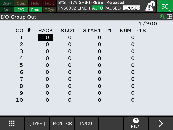

Users must first navigate to the group I/O page on the FANUC teach pendant to configure group inputs or outputs. To do so, press menu >, highlight “I/O,” move to the Group tab, and press ENTER.
Group output menu page
Figure 6. Menu for group outputs on the FANUC teach pendant.
Configuring group I/O is very similar to digital I/O, except that we must determine how many digital points are to be included in the groups.
To configure the group outputs or inputs, press F2, CONFIG. Then, determine the digital I/O signals intended for grouping. Remember that when you define a group input or output, it must contain between 2-16 signals; these signals must all use the same communication protocol (rack), and must be in the same slot.
Configuring group I/O in a FANUC controller
Figure 7. This is the group output configuration page on the FANUC teach pendant.
We can receive group inputs from Ethernet, perhaps to receive positional target values, in which case we can use rack 89, slot 1. Or, perhaps we have an array of sensors to determine the size of a pallet, so we could use rack 48, slot 1.
After determining the signal source, enter the start point and the number of points from the digital I/O page. For example, if we wanted a 5-bit GO starting with DO[22], the start point would be 22 and the number of points would be 5. Now, points 22-26 would be grouped. If you are already using digital I/O for other signals, do not use those same points in the new group I/O.
Press "NEXT" and verify that the assignments are correct. Finally, cycle power to enable the changes.
