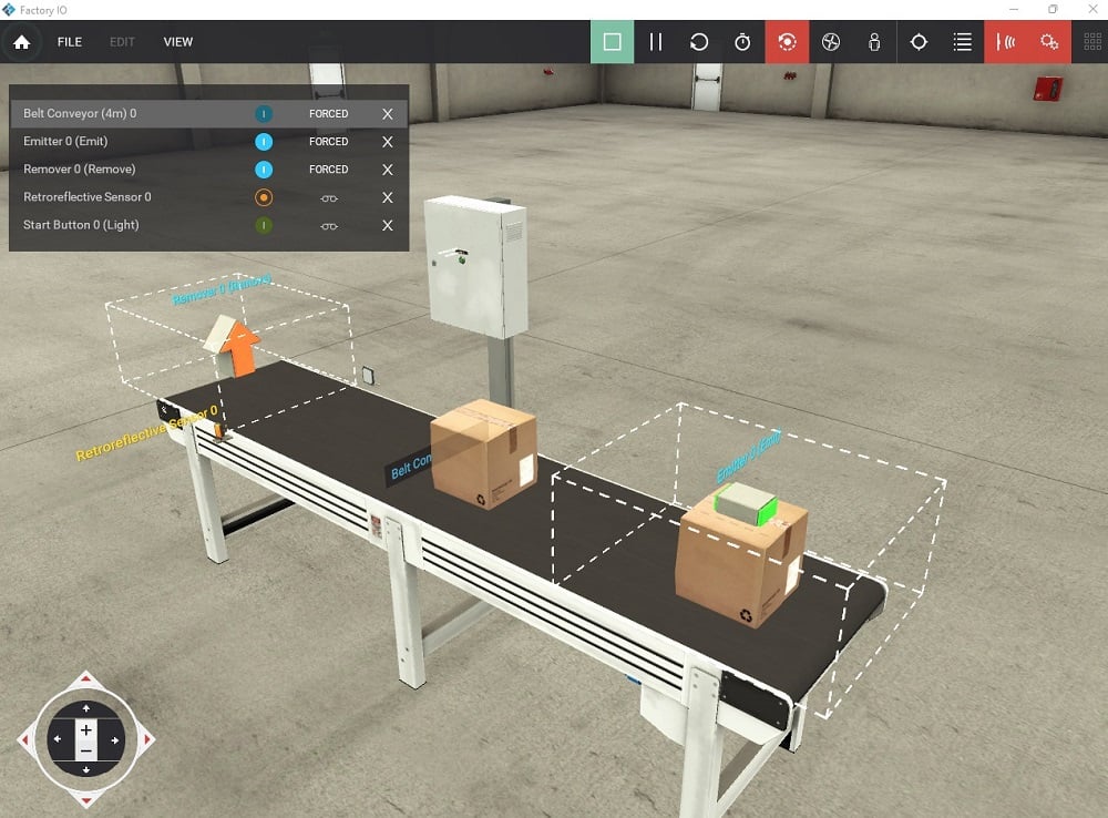

For this guide, we will consider an example scenario of a simple conveyor system that transports items from point A to point B within the system and uses a sensor to count the items. The scene features an emitter, one of the Factory I/O components that emits the process items (the boxes), and a remover component that receives and removes the boxes, as shown in Figure 1. We could think of these like the infeed and outfeed sections of a modular conveyor.
 Figure 1. Conveyor system with sensor, emitter, and remover components in a virtual 3D factory environment.

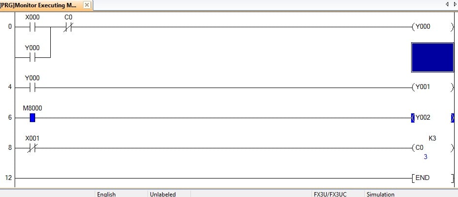

Launch GX Works2 and create a new project, selecting the PLC series that matches your control needs. For this example, we are using the FX Series PLC type.
Once created, add the first line of logic to activate the conveyor (line 0) and the emitter (line 4) using latching. Use a normally closed instance of the counter in series to deactivate the conveyor after three counts of boxes.
To activate the remover component, we will use the "always ON" contact M8000 (line 6).
To provide the counting action (line 8), the sensor sends a pulse to trigger the count whenever a box passes by. K3 denotes the count value, and C0 represents the counter device number.
 Figure 2. Ladder logic implementation for the sample scene.
