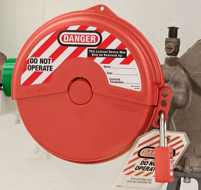

 Figure 1. This valve handle cover is locked out and tagged out (LOTO) to prevent it from being opened during maintenance.
Figure 1. This valve handle cover is locked out and tagged out (LOTO) to prevent it from being opened during maintenance. Image used courtesy of Uline

The general idea behind LOTO is creating an organized, traceable method of eliminating the possibility that a worker will be exposed to hazardous energy sources. For example, consider the maintenance technician who decides to work on a large hydraulic press. He needs to crawl through the press to perform the repair. If he simply unplugs the press and begins his work, some other technician may walk in, see the press unplugged, and plug it in. The press begins working again, likely injuring or killing the technician.
With the preferred LOTO procedure, the technician unplugs the press. They place the plug in an enclosure and then lock it with their unique lock. This way, if someone walks through and sees the unplugged press, they physically cannot plug it in. The technician also fills out a tag with their name, contact information, and date, and likely also sends out an email or text, communicating that the press is out of service. A similar procedure is likely repeated on the hydraulic supply to release built-up system pressure.
When the work is finished, the repair technician uses his unique key to open the lock and bring the press back into service.
