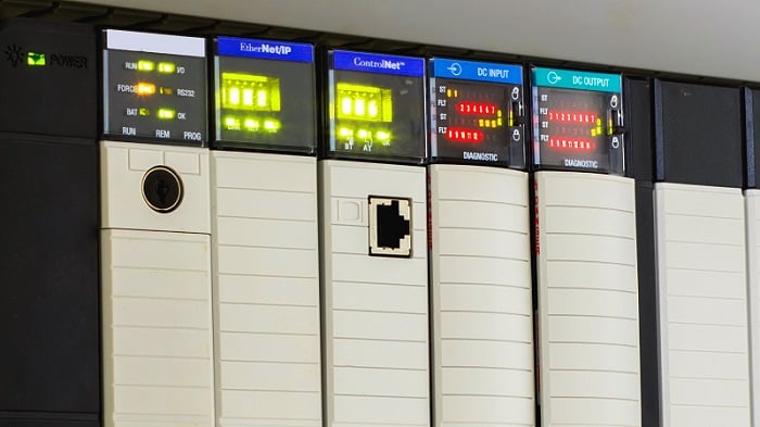

Errors
Errors will usually announce themselves as LEDs, but if you need access, say for an HMI or remote dashboard, these values can indicate the type, location, and severity of faults and errors.
 Figure 2. Understanding faults can be critical to troubleshooting.
Figure 2. Understanding faults can be critical to troubleshooting. Image used courtesy of Adobe Stock

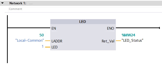

Siemens S7-1200
The S7-1200 provides function blocks that retrieve specific values, such as system time, run/stop mode, and errors. These function blocks have separate names for each task, including Get_IM_Data, which returns CPU ID information; LED, which returns the CPU execution mode; GetStationInfo, which provides IP address information; and others.
 Figure 3. LED status of Run and Stop modes in a Siemens PLC.
This listing also applies to the S7-1500, and a full listing of those instructions is found in the online help guide.

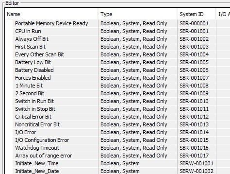

AutomationDirect Productivity
In this PLC, the system values are readily available as tags. A full list and description of the tags can be found in the application help and in online help documentation.
 Figure 4. Sample of AutomationDirect system tags.
