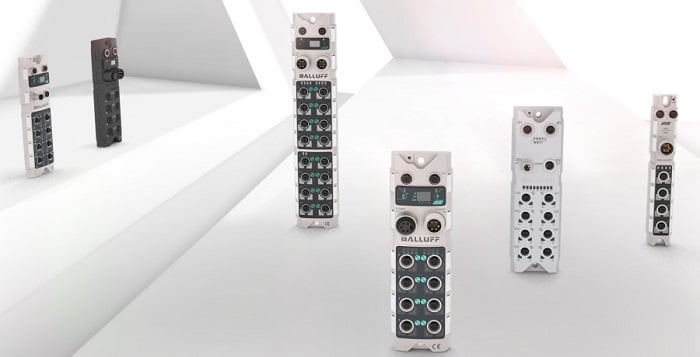

 Figure 1. A collection of Balluff IO-Link masters.
Figure 1. A collection of Balluff IO-Link masters. Image courtesy of Balluff
What Is IO-Link, Anyway?
The IO-Link topology consists of a master device, optional signal distribution, and one or more end devices. The end devices can be flow meters, I/O blocks, analog sensors, motor drivers, or even other IO-Link masters, just to name a few. The devices plug into the master with standard M12 cables, and the master offers a bridge to communicate to a control system using a field bus of your choosing. Standard field buses are supported, such as PROFINET, Ethernet/IP, Modbus, and EtherCAT. Some PLC manufacturers are even offering standard IO-Link ports or modules integrated into the controller.
Each device that plugs into the master contains real-time monitoring, configurable parameters, and diagnostics, in addition to the normal I/O data. This data is accessible over the fieldbus protocol and is mapped into different registers (tags) in the PLC. This makes even a simple sensor able to be configured remotely without the need for dip switches or special wiring.
The wiring of an IO-Link system is always the same, which makes the design and manufacturing of IO-Link devices simple. The data is sent over a two-wire digital communication so that the signal is not susceptible to electronic noise.
