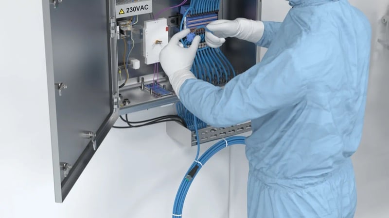

Pepperl+Fuchs designed the certified M12 connectors with installation and maintenance in mind. Because the cables and cordsets carry EU type-examination certification, installers may not need to perform the same level of verification typically required when building intrinsically safe circuits from uncertified components.
These connectors can be worked on without additional permits during normal operation.
These connectors can be worked on without additional permits during normal operation. Image used courtesy of Pepperl+Fuchs
The connectors can also make maintenance easier in operating plants. Depending on the industry and environment, servicing electrical circuits can require special permits for work involving ignition risks. With intrinsically safe and certified connection technology, certain maintenance tasks can be performed during normal operation, reducing downtime and simplifying service planning.
