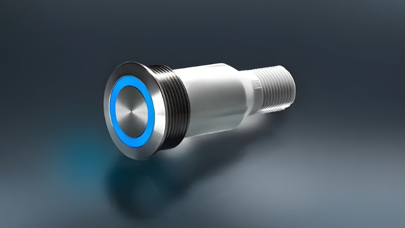

Recently, Schurter has expanded its MSM II switch family with a new version featuring an integrated M12 connector (8 pins). The new switch is engineered for demanding industrial environments where installation speed, mechanical durability, and clear status indication are extremely important.
Schurter’s MSM II Switch with a standardized M12 connector
Schurter’s MSM II switch with a standardized M12 connector. Image (modified) used courtesy of Schurter

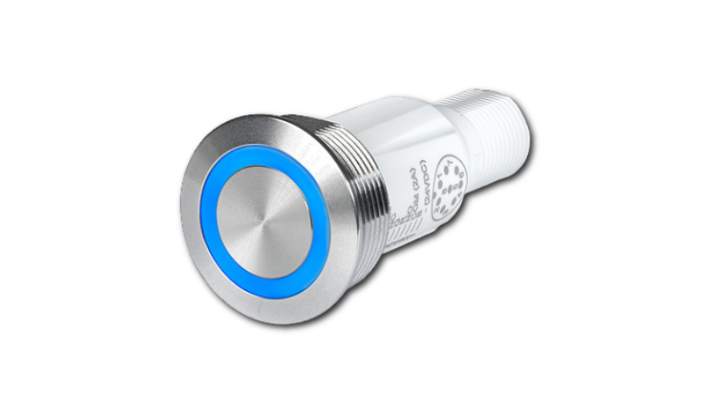

The MSM II switch with M12 connector is housed in stainless steel and is shock- and vibration-resistant
The MSM II switch with M12 connector is housed in stainless steel and is shock- and vibration-resistant. Image used courtesy of Schurter
Mechanical Design for Industrial Environments
The MSM II M12 switch is built for continuous industrial use. The housing is manufactured from stainless steel, providing resistance to mechanical stress and environmental exposure. Actuator options are available in stainless steel or ceramic, depending on application requirements.
The design is shockproof and vibration-resistant, which is important in machinery operating under constant motion. Over time, repeated vibration and impact can affect components that are not engineered for these conditions. The MSM II platform is intended to maintain consistent performance in such environments.

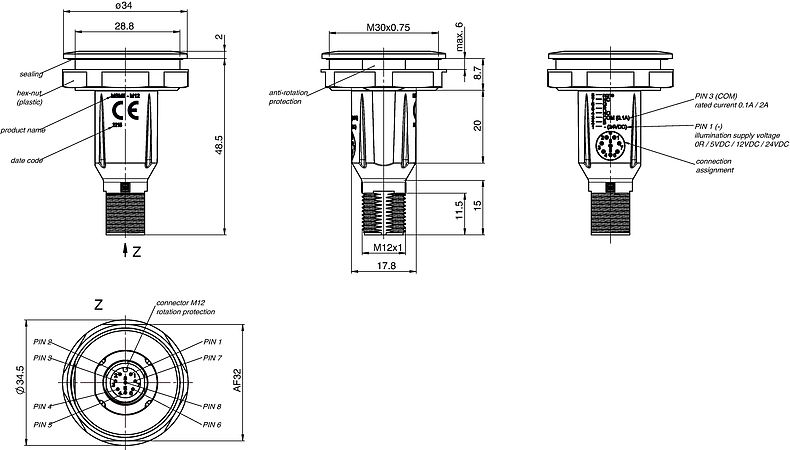

The MSM II M12 switch operates with a momentary (MO) stroke and includes torsion protection to assist with positioning during installation. Electrical specifications include switching voltages from 30 VDC (0.1 A microswitch) up to 30 VAC/VDC (2 A microswitch). Switching currents range from 0.1 A to 2 A, with gold contacts rated at 100 mA available for lower-current applications.
Technical drawing of the MSM II M12 switch showing dimensional layout, M30 mounting thread, and 8-pin M12 connector configuration
Technical drawing of the MSM II M12 switch showing dimensional layout, M30 mounting thread, and 8-pin M12 connector configuration. Image used courtesy of Schurter
