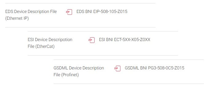

When the IO-Link master is added to the controller, it may be through the installation of an electronic datasheet (EDS) or the creation of a generic Ethernet module. For EtherCAT, the alternative to an EDS is an EtherCAT Subdevice Information file (ESI), and for PROFINET, the file is called a General Station Description (GSD). The appropriate file must be added to identify the number and integer size of input, output, and configuration words.
 Figure 3. The file downloads for three different types of IO-Link masters, one product for each network.
Figure 3. The file downloads for three different types of IO-Link masters, one product for each network. Image (modified) used courtesy of Balluff
How to translate and actually use those command words varies by IO-Link master, and at an even deeper level, it varies by the actual I/O device that’s connected to each port, and we’ll cover some examples of these process data variables in a separate article.
