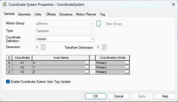

 Figure 2. Configuration of the system properties.
Figure 2. Configuration of the system properties. Image used courtesy of the author
The first step is to create a coordinated system. To do this, right-click on the motion group and choose New Coordinated System. A new tag window will open, with the required data type already populated, where you can create the coordinated tag name.
Open the Coordinated System Wizard to define the system properties. You will need at least two servos already configured. If you are using the emulator, you can use a maximum of three virtual axes. From this wizard, you can select how many axes are in your system, the geometry of the system, any offsets, the units of the system, and maximum motion parameters.
