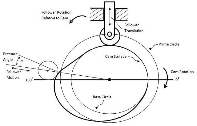

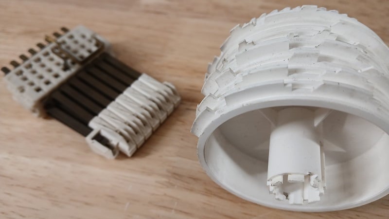

A cam is a mechanical interaction where a shaft rotates an off-round, or lobed disk. The lobes are designed precisely so that a constant RMP of the shaft causes offset motion of a follower. It is a repeating cycle, but within a single revolution, there may be many small, irregular offsets.
In an electrical motion system, a single, constant RPM axis guides a second follower axis with offsets that act exactly like a mechanical cam.

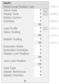

A cam motion requires a Motion Axis Potion Cam (MAPC) block and a position cam profile. The profile is an array of values that relate the positions of the slave and master axes, determining how the slave axis should move in relation to the master axis. This profile can be created using the built-in editor or through a Motion Calculate Cam Profile (MCCP). The MCCP block allows the cam profile to be altered and then calculated programmatically within the logic.

When the MAPC block is initiated, the designated cam profile is loaded, and the slave axis will be locked to the master axis, as set by the parameters. A Motion Axis Move (MAM) block will be needed to start the master axis moving. The MAPC block will evaluate each index of the position array and will move the slave axis to each respective position as the master moves through the cam profile.
The slave axis is driven to its specified position without any regard to maximum speed; both the master axis and slave axis reach the end positions at the same time. This means that if you have large movements between each index of the profile array, the slave axis will work very hard to reach its positions and could cause the system to fault.

Similar to the gearing motion block (as discussed in a previous article), you will need to define the master axis and slave axis, and the direction in the parameters of the MAPC block. A unique feature of the cam motion profile is the ability to set the block as continuous, one-time execution, or persistent.
  • Continuous allows the motion profile to continuously run without having to re-execute the block. This is useful in rotary applications.
  • Persistent will automatically engage and disengage the cam when the master axis travels inside the cam profile range.
  • A one-time execution will engage the slave axis until the cam boundary is met. Once the master crosses the boundary, the MAPC block will need to be executed again.
 Figure 4. Full listing of MAPC parameters.
Figure 4. Full listing of MAPC parameters. Image used courtesy of Rockwell Automation
The next set of parameters defines when to execute the cam profile.
  • The Execution Schedule informs the system if you are blending cam profiles, issuing a new profile, or if the cam profile will be used in a forward, reverse, or bidirectional motion.
  • The Master Lock Position is the point at which, along the master axis, the slave axis will be locked to the master.
  • The Cam Lock Position defines where you want the cam profile to start.
  • Cam Type defines how to initiate new or replacement cam profiles, and whether to interpolate new positions immediately or to wait until the cam lock position.
  • The Master Reference determines where you want the slave position generated from, either the actual position of the master or the commanded position of the master.
  • Master Direction allows altering the direction of when to engage the cam profile. Either in the forward direction or only when the master axis is travelling in reverse. The bidirectional setting will allow the slave axis to track the master in either direction.

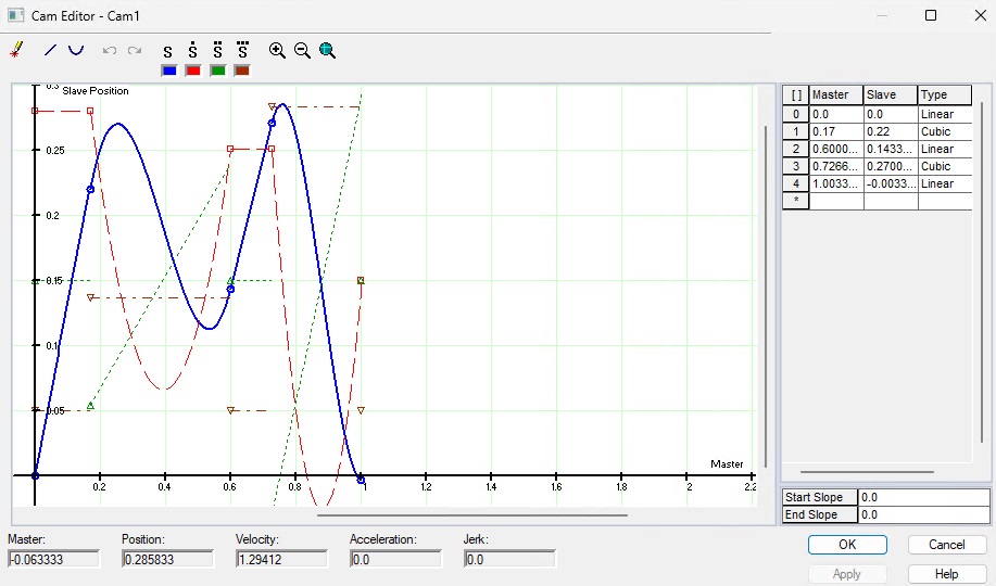

Studio 5000 includes a cam profile editor that can be used to generate the motion of each axis. Insert cam segments into the editor to define positions for both the master and the slave axis. Ensure to use mostly cubic-type moves, especially for direction changes; a cam profile with only linear positions will fail to execute because it is being commanded to change velocity from positive to negative in a moment, and this is impossible. Adjust the start and end slope to ease the transition into and out of the cam profile.

Using CAD Software To Develop A Cam Profile
Developing a cam profile using the Studio 5000 software can only be done while offline with the controller and will require a download if it changes. It’s also hard to visualize the path each axis will take to arrive at its destination. Using CAD software with simulation packages, you can move the tooling through the process and record the positions. If changes need to be made, you can always resort to that CAD model and run the simulation again.
