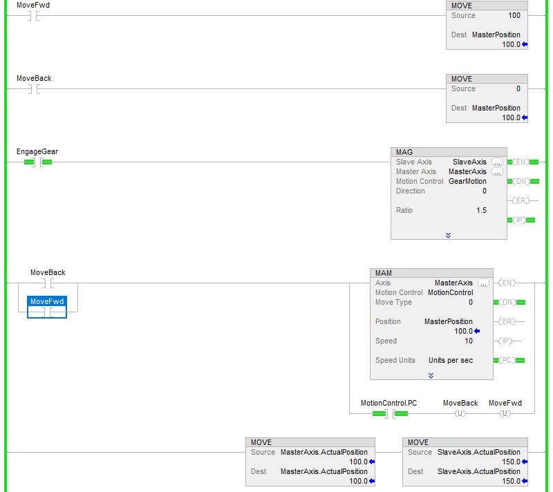

Place a MAG instruction near the MAM instruction, and place any conditions in front of the MAG that your application requires. When the MAG rung is true, the two motors will move in a synchronized motion once the master axis is commanded. To ungear the slave servo, you need to issue a MAH (motion axis home) or MAS (motion axis stop) command. This will cancel the MAG command and unlock the slave servo from the master.
In the code example below, we have a simple linear axis that moves forward and backward 100 mm, specified in the MOVE commands, alternately placing 100 or 0 in the MasterPosition.
When the master axis is commanded to move forward, the slave axis moves at 1.5 times the speed of the master (indicated in the MAG) and therefore will arrive at an end position of 150 mm, exactly 1.5 x 100.
 Figure 4. A sample program with a 1.5 gearing ratio.

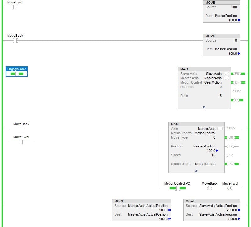

If we change the MAG ratio to 10, the slave axis will move to a position of 1000 mm while the master remains at 100 mm. Changing the ratio to a negative value will drive the slave axis in the negative direction. For example, as shown in Figure 5 below, a -5 ratio value results in the slave axis traveling -500 mm.
