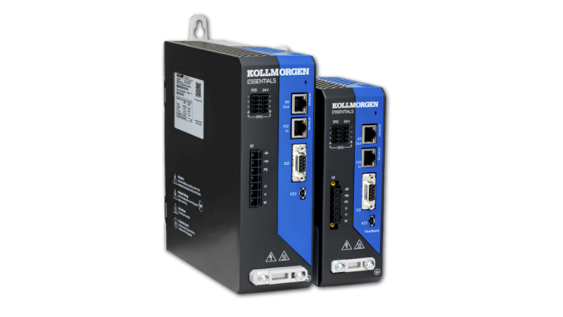

Kollmorgen has expanded its Kollmorgen Essentials Servo Drive (KED) platform to support washdown and hygienic environments. These new drives are specifically designed for applications in food processing, packaging, and other areas where equipment is regularly exposed to harsh cleaning conditions.
The update integrates KED drives with AKMA aluminum washdown motors and AKMH stainless steel hygienic motors, along with SFD-M absolute feedback. This new combination provides multi-turn positioning, industrial Ethernet support, and integrated safety, all while keeping system costs and complexity in check.
Kollmorgen has expanded its KED platform to include hygienic and washdown models
Kollmorgen has expanded its KED platform to include hygienic and washdown models. Image used courtesy of Kollmorgen
Kollmorgen Essentials Servo Drives (KED)
