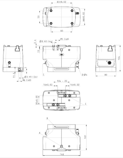

Engineering drawing of the Series CSPT collaborative gripper showing overall dimensions, mounting points, and mechanical layout for system integration.
Engineering drawing of the Series CSPT collaborative gripper showing overall dimensions, mounting points, and mechanical layout for system integration. Image used courtesy of Camozzi
The platform also includes gesture recognition and position-monitoring capabilities that support more interactive and adaptive workflows. Rather than executing the same motion repeatedly, the system can respond to changing conditions. This makes the gripper particularly well suited for collaborative robotic systems where precision and adaptability are both important.
