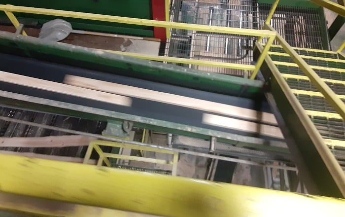

Belt Conveyor
This style of conveyor uses a low-friction belt that allows pallets or objects to slip on the belt when they are held by a person or a pallet stop. Sometimes, the conveyor is one large belt, and other styles have a belt for each side of the conveyor, with the center of the conveyor hollow.

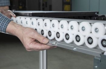

Roller Conveyor
This conveyor style uses rollers driven by interlocking gears or rubber belts/bands. Each roller will have some kind of bearing pressed into the roller. When objects come to a stop, some conveyors will allow the rollers to slip on the bearing, while other rollers have a low friction surface.
 Figure 3. Dorner ERT250 edge roller showing how motion is transmitted to all the rollers with nylon gears.
Figure 3. Dorner ERT250 edge roller showing how motion is transmitted to all the rollers with nylon gears. Image used courtesy of Dorner Conveyors

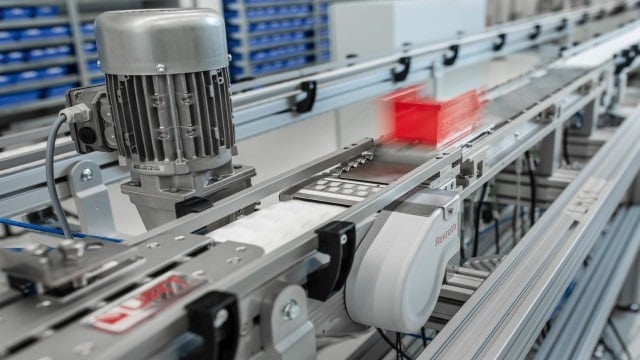

 Figure 4. Bosch FTS system moving pallets through a section at a high rate of speed.
Figure 4. Bosch FTS system moving pallets through a section at a high rate of speed. Image used courtesy of Bosch Rexroth
Seveo Motion - A more advanced conveyor system is the linear servo conveyance system. This conveyor style uses linear servo motors to move a pallet around a magnetic track. A great automation solution if your application has a small and light payload. The feedback from the system allows users to track and queue pallets without special PLC logic or even extra sensors. With the system using servo motors, the positional feedback of each pallet can be down to the micrometer level and reach speeds of 5 m/s. An example is the Bosch FTS system which allows designers to create servo-driven sections. These sections have the speed and accuracy of linear servo conveyors but are only in the sections where needed.

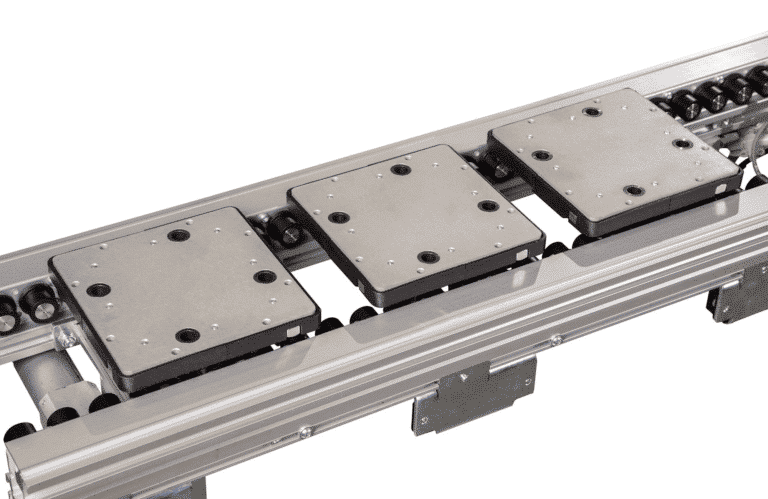

 Figure 6. A pallet edge roller conveyor system.
Figure 6. A pallet edge roller conveyor system. Image used courtesy of Dorner Conveyors
Stop And Go Motion
Another method of conveyor logic can only be done with the roller-style conveyor. A roller conveyor design will have multiple motors, each driving its own section of the conveyor, essentially creating zones of motion. The control system can then start, stop, or even change the speed of each section as needed.
An application might be a station that requires pallets to continuously move through the station and not stop, while there might be a station before and after that requires the pallets to stop for some interaction. In this application, it might be preferred to apply continuous motion between stations, while the stations themselves rely on faster, stop and go strategies.

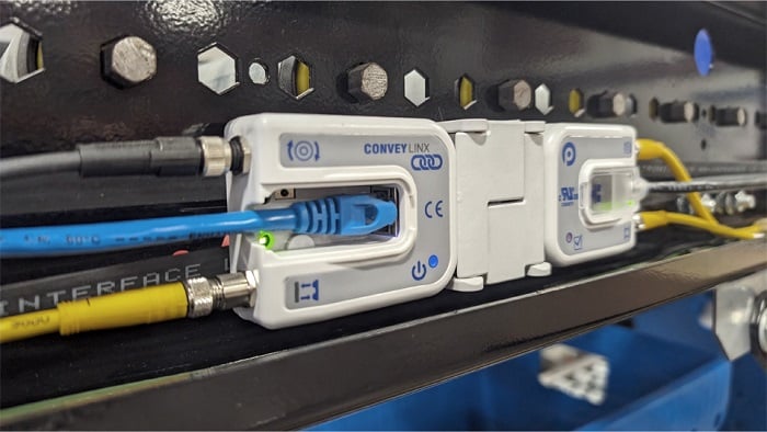

 Figure 7. DC motor controller for a roller conveyor system.
Figure 7. DC motor controller for a roller conveyor system. Image used courtesy of Pulseroller
Conveyor Logic
Some conveyors can have logic within the conveyor controller itself. The controller will have inputs and outputs, and each section of the conveyor is programmed to do different tasks. Pallet present sensors can be wired directly to the controller and even lift transfer units can be connected to the controller and control pallet traffic through the system.
