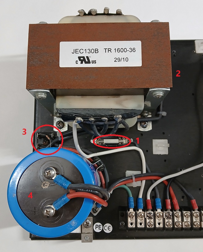

Linear supplies provide more power and are often used for motion devices. They tend to be more expensive, which means that repair might be more cost-efficient. Even still, hours of testing and repair may be more costly than a whole new supply. But the structure of a linear supply is fairly simple, so testing isn’t too bad.
First, a transformer (usually a large one) will have an input primary coil side with the supply AC voltage across it. The secondary coil voltage should be stated somewhere on the datasheet or the part sticker, and can also be measured as AC voltage. There is usually a fuse in-line or even built into the transformer. This may be the failed component.
Next, a bridge rectifier consists of two diodes always in series with each other at any time. All following components, such as the smoothing capacitor, will now show DC voltage. Be careful when testing capacitors; they can often store a dangerous charge, but the high impedance of a voltmeter creates a safe test for these relatively low voltage supplies. The section between the rectifier and the regulator can really only be correctly measured with an oscilloscope.
Linear power supply components
Figure 4. This linear power supply has a fuse (1) in-line with the transformer (2) that has primary and secondary terminals, the bridge rectifier (3), and a capacitor (4). This type of supply would be quite expensive, and the ease of component replacement might make a favorable repair.
A voltage regulator is the final component before the load terminals. The output of the regulator should be a smooth, constant DC output, and can once again be tested with a DC voltmeter. Sometimes the output is an adjustable linear supply, like with a common benchtop double or triple-output supply. These regulators can also be tested, but there needs to be some method of calculating the correct output voltage or the measurement will be meaningless.

  • rogerval September 18, 2020
    Thanks for the article, it was interesting.
    However, I have a query about the photo which is supposed to depict a “linear power supply”.
    Looking at the number of chokes, and what appears to be a high frequency transformer instead of an iron cored mains transformer, I suspect that this is a switchmode power supply of some sort.
    Kind regards, Roger Valmadre.
