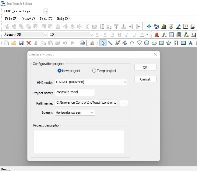

Open InoTouch Editor and start a new HMI project by clicking ‘File’-> ‘New Project’. In the ‘Create a Project’ window, set the project name, choose the HMI model, and select the communication preference. For this example, we’ll set the screen to horizontal and pick our exact IT6070E (800x480) model. You can find the model number on the back of the HMI panel.
 Figure 2. The new project setup window featured in the InoTouch Editor software.
After finishing the setup in Figure 2, click OK. A new window will appear to set up the device, which is the controller paired with the HMI.

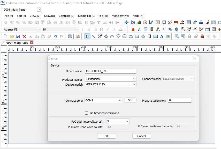

Setting up Serial PLC Communication
Inovance HMIs work with many PLC models. Click the dropdown under ‘Producer Name’ and choose Mitsubishi. Then, select the device name for your specific controller model.
 Figure 3. Selection of COM2 for RS-232 configuration.
After choosing the right device, pick the communication port that matches your controller.
The IT6070E has two DB9 ports: COM1 for RS-422/485 and COM2 for RS-232. For this project, we will use COM2 (RS-232) via a DB9 <-> MD8 cable for the connection. The Mini DIN 8-pin DB9 uses signal conversion to connect RS-232 (single-ended) to the PLC’s MD8 port, which uses an RS-422 for less noise.
In the device setup, select COM2 for RS-232. You can adjust settings like baud rate, parity, and data bits by clicking ‘Set’, but the default settings usually work well.
NOTE: This is not the communication for PC programming, so do not use the COM port assigned to your USB connection in your PC’s Device Manager.

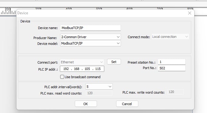

InoTouch Editor Modbus TCP Configuration
When using Modbus TCP, InoTouch Editor requires the Common Driver (ModbusTCP/IP). Unlike vendor-specific drivers, the Common Driver communicates using standardized Modbus objects, requiring explicit register mapping on the PLC side.
To set this up in the device configuration window, choose ‘2-Common Driver’ instead of Mitsubishi in the producer name dropdown, and select ModbusTCP/IP as the device model. Set the connection port to Ethernet and enter the PLC’s Ethernet IP address in the ‘PLC IP addr’ field, since the FX5U acts as a Modbus TCP server. Keep the port setting at 502, which is the default for Modbus.
 Figure 4. Device setup window for Modbus TCP, in which the HMI’s IP is assigned to 192.168.105.115.

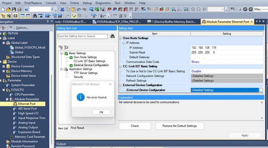

Verify PLC IP Address
Over in GX Works 3, the FX5U should be configured with the same IP as the one assigned InoTouch, in this case 192.168.105.115, and the subnet mask as 255.255.255.0. This can be done by accessing the project’s navigation tree under the module parameter and clicking Ethernet port.
 Figure 5. Image of GX Works 3 Module parameter setting for the PLC Ethernet port.

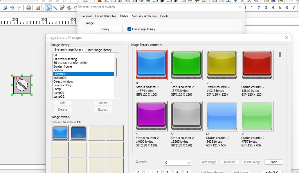

After assigning a PLC address to the switch, set whether it will be a transfer (selector) or a momentary switch. To change the appearance, click the Image tab, then select the library to see the available pre-designed button and lamp designs that fit your project. You can also upload your own images in Bitmap format for the bit switch or lamp.
 Figure 7. Image library selection for buttons and lamps.

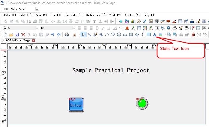

Next, add a bit lamp to the design area from the control tab. After adding it, set the PLC output address for the lamp to M0, and change its image and color to fit your design.
 Figure 8. The 'Download' window configuration.
You can also add and format text labels for the individual objects, or for the screen itself.
