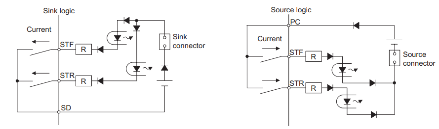

A jumper is used to select between sourcing or sinking configurations, which, in this case, refers to the type of devices that will be connected to the inputs. If in sourcing mode, the PC (common +V terminal) must be connected via a switch to either the STF or the STR terminal for directional control. Or, if in sinking mode, the SD (common GND terminal) must be connected to the STF/STR terminals for directional control.
 Figure 2. The circuits show the sink and source logic connection and current flow.
Ensuring the VFD's control input logic type matches the controller's output type is essential to maintain sink/source compatibility. Mismatching these types can lead to improper control signal operation or potential damage to the inputs.
