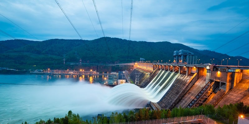

Hydroelectric power generation facility
Figure 1. Calculation data for water flow, power factor, and energy production from a hydro facility. Image used courtesy of Adobe Stock
