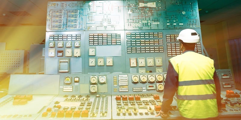

Technician monitoring a display and control panel
Figure 2. Monitoring, tracking, and reporting data is the main purpose of the UDW. Image used courtesy of Adobe Stock
