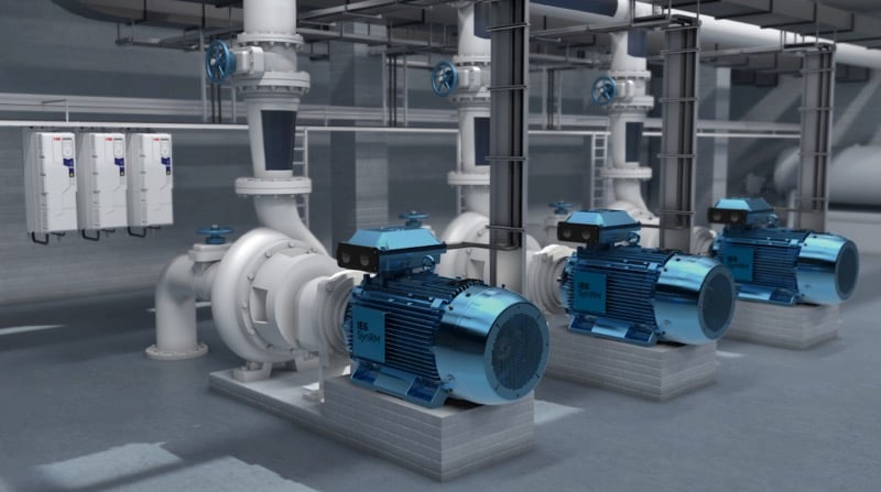

ABB IE6 Hyper-Efficiency SynRM motors installed in a pumping application.
ABB IE6 Hyper-Efficiency SynRM motors installed in a pumping application. Image used courtesy of ABB
The motors are designed to deliver measurable gains in energy performance compared to both IE4 induction motors and IE5 ultra-premium efficiency alternatives. ABB estimates a total cost savings or cost avoidance of €51,200 and a reduction of approximately 92,200 kg of CO₂ emissions when upgrading from IE4 to IE6 over a 20-year service life in a 110 kW application running continuously at 75 percent load. Moving from IE5 to IE6 represents an additional 76 percent improvement in savings and emissions reduction, with a reported return on investment of approximately eight months.
Unlike permanent-magnet motor designs, SynRM technology eliminates the use of rare-earth metals and permanent magnets. The motors are 98 percent recyclable and are included in ABB’s EcoSolutions portfolio with verified Environmental Product Declarations (ISO 14025 Type III). Designed to match the dimensions of standard induction motors, the IE6 SynRM range enables drop-in replacement in pumps, fans, compressors, and other industrial applications, particularly when paired with ABB variable speed drives.

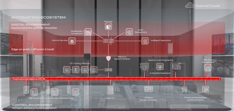

ABB’s Automation Extended architecture separates mission-critical control from a digitally enabled environment for analytics and AI integration.
ABB’s Automation Extended architecture separates mission-critical control from a digitally enabled environment for analytics and AI integration. Image used courtesy of ABB
The architecture is based on a separation-of-concerns model that divides the automation ecosystem into two interconnected environments. The control environment maintains deterministic, mission-critical process control. The digital environment, securely connected to the control layer, supports advanced analytics, artificial intelligence, edge applications, and real-time decision support without interfering with core operations.
An open, modular framework supports interoperability and scalability through technologies such as OPC UA backbones and cloud-native architectures, leveraging containerization and orchestration. This approach enables industries to introduce new capabilities, including predictive analytics, condition monitoring, and anomaly detection.
