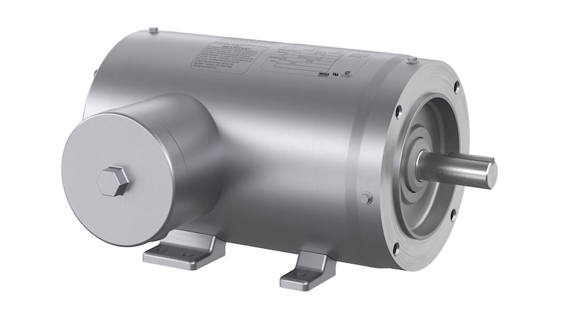

ABB has upgraded its Baldor-Reliance Food Safe stainless steel motor lineup with an innovative three-lead electrical connection configuration. (Note that the nine-lead motor will still be readily available.) This optimization effectively streamlines the installation process, reducing overall setup or change-out time for food and beverage processing facilities. The likelihood of connection errors is significantly diminished by minimizing lead count, enhancing the system's reliability and minimizing operational interruptions.
The new three-lead motor for ABB’s Baldor-Reliance series of stainless steel motors.
The new three-lead motor for ABB’s Baldor-Reliance series of stainless steel motors. Image used courtesy of ABB
