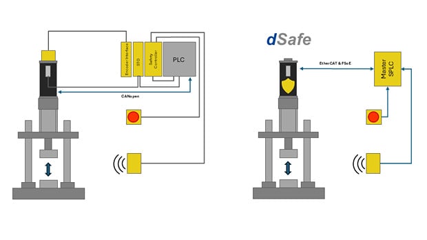

A motor drive provides conditioned power to a motor as the PLC commands it, but there must be some safety systems in place to stop the motor in the event an operator enters the area. Functions like safe torque off (STO), safely limited speed (SLS), and safe stop (SS1) are some of the common safety functions you might find on a typical motor drive. These functions are commonly activated by wired signals from safety control systems.
Dunkermotoren’s latest dSafe technology is capable of executing these safety functions over a communication protocol such as FSoE or PROFIsafe. This eliminates the need for wiring safety outputs to drive systems and for troubleshooting the wiring or drive system when the functions fail to execute. Currently, dSafe is only available on Dunkermotoren’s BG75 and BG95 series of brushless DC motors.
With dSafe, users can avoid complex wiring that a traditional setup would require
With dSafe, users can avoid complex wiring that a traditional setup would require. Image used courtesy of Dunkermotoren

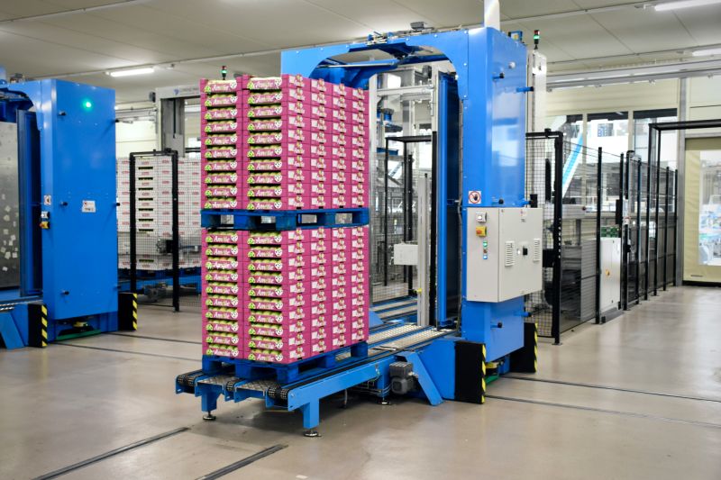

Packaging machines with open concepts require advanced safety feature sto keep operators safe
Packaging machines with open concepts require advanced safety features to keep operators safe. Image used courtesy of Unsplash
