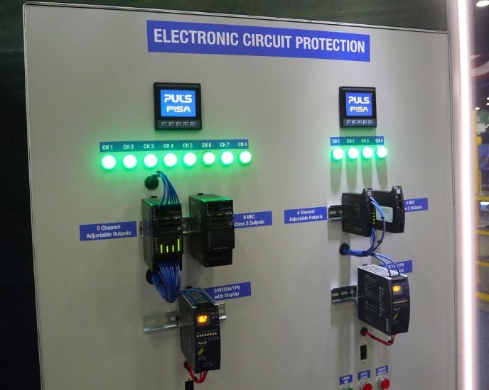

The PISA electronic circuit breaker series
The PISA electronic circuit breaker series.
The PISA-B has 8x adjustable-limit Class 2 outputs, and if you need more outputs, a bus-bar connection on the front can expand the output circuits, provided that the external power supply is sufficient for the task. Simple LED bar graphs show the current set limit and the actual current, with the color changing depending on the overcurrent setting. Like the FIEPOS series, the outputs can also be individually switched on/off with the controls.
Most of the configuration is done by pushbutton, but a digital two-way pulse-code communication allows alarms to be monitored and reset remotely. The flexibility of this system can greatly enhance the responsiveness to power issues around a facility.
