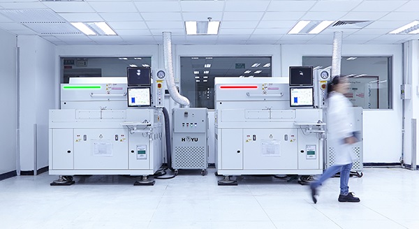

The latest product from WERMA Signaltechnik is the linear LineLIGHT Fusion indicator for new machines and retrofits. This signal arrangement, projected to be available in March 2025, uses 24 V signals in a variety of available colors and lengths, and an optional acoustic signal for maximum usefulness.
Machine status signaling is one of the few automation tasks that combines function and ergonomics with a pleasing aesthetic design. The new linear indicator from WERMA is modular, with lengths from 50 to 1500 mm and a robust IP65 design with flush edges to prevent the buildup of contaminants in hygienic environments.

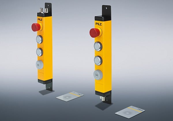

The newest safety unit from Pilz incorporates RFID permission capability into a safety pushbutton box directly on the access point of the machine center, bringing together required mechanical inputs and smarter controlled access for better response and uptime.
How does RFID increase uptime? In a recent meeting with Pilz at Pack Expo, I learned about the benefits firsthand. With network access, personnel with various permission levels can enter the work cell, locking out all aspects of the machine as appropriate from a single point. When the repair is complete, everyone can exit the work cell and reset the system to order, again from a single point. Compared to retrieving and resetting multiple personnel lockout keys for multiple points around the machine, the system restoration is much faster.

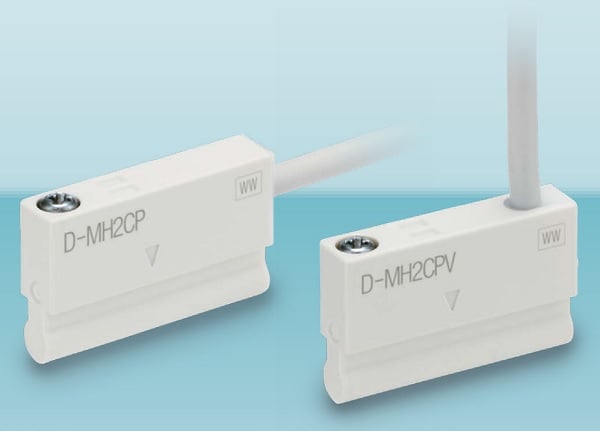

Detecting the position of a robot gripper or small actuator can be done with a single sensor, providing feedback for up to three position statuses: fully open, gripped, and error on gripping (no object detected). It could also detect fully gripped on two different objects.
The IO-link compatible sensor is designed to be mounted into the t-slot on the side of most grippers and cylinders, and can be programmed with a standalone unit or through the IO-Link connection in the controller. Through NPN/PNP discrete outputs or the digital IO-Link protocol, the sensor can provide the 3x digital set point signals, as well as a linear position value with a resolution of up to 0.1 mm when IO-Link is employed.

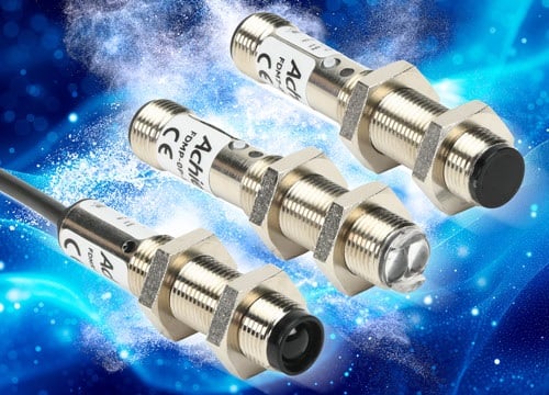

Industrial automation supplier and manufacturer AutomationDirect has expanded the catalog of AchieVe tubular photoelectric sensors with the new FDM 12 mm series.
The new sensor lineup is available in the typical sensing modes: reflective, diffuse, and through-beam, with IR and visible red for some models. The series is constructed from durable metal with IP67 ratings and an adjustable sensing distance of up to 4 meters.
