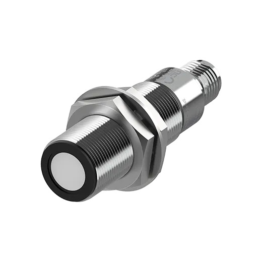

Autonics’ UTR series of cylindrical ultrasonic sensors can detect various types of materials and surfaces.
Autonics’ UTR series of cylindrical ultrasonic sensors can detect various types of materials and surfaces. Image used courtesy of Autonics

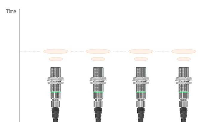

With the UTR series sensor synchronization function, users can widen detection range with up to ten sensors working in unison.
With the UTR series sensor synchronization function, users can widen the detection range with up to 10 sensors working in unison. Image used courtesy of Autonics
