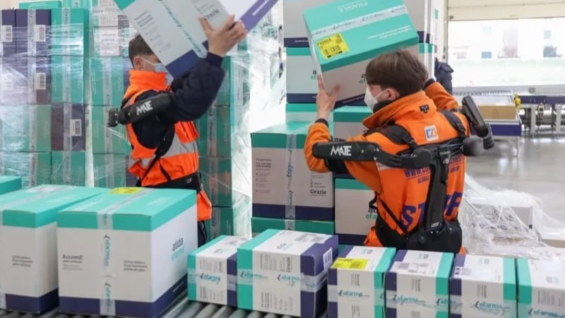

Workers at the Italian logistics company Temi Spa use the MATE-XT upper-limb exoskeleton to handle boxes more safely.
Workers at the Italian logistics company Temi Spa use the MATE-XT upper-limb exoskeleton to handle boxes more safely. Image used courtesy of Comau

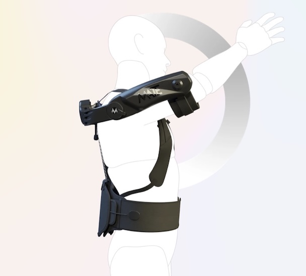

The MATE-XT GO features a lock/unlock mechanism that facilitates natural movement and supports manual tasks. Image used courtesy of Comau.
What is it, and How Does it Work?
The MATE-XT GO provides biomechanical support through alleviating pressure on the body’s musculoskeletal structure. The assistive device is made of non-toxic, non-allergenic materials and features adjustable elements to accommodate different body types. The physical human-robot interface (PHRI, or the components that attach to the human frame) consists of T-structure padding (from the spine to the shoulders), a waist belt, a lumbar pad, shoulder straps, base arm supports, an adjustable front buckle, and belt extensions. The MATE-AT GO is certified as Personal Protective Equipment (PPE – Category II) in accordance with EU Regulation 2016/425.
The materials of the MATE-XT GO are removable, hygienic, breathable, and washable. A kinematic design fosters natural movement, providing workers with freedom of movement and comfort while working. The T-structure of the back and shoulder padding is made of carbon fibre to distribute workloads and help support good posture while undertaking tasks. The lumbar belt enables weight transfer to the hips, easing pressure on the back and mitigating unwanted strain.
MATE-XT GO features a chain of passive degrees of freedom, which means that joints move freely within a kinematic chain, independent of the motor/actuator. This means the shoulder axis (for extending and flexing) is aligned with the MATE-XT GO's axis for improved freedom of movement.
As the arm moves, the mechanism stores and releases energy, adjusting to the shoulder's angle and its physiological position. Assistance is zero when the arm is in a neutral position and increases as the arm reaches a steeper angle.
