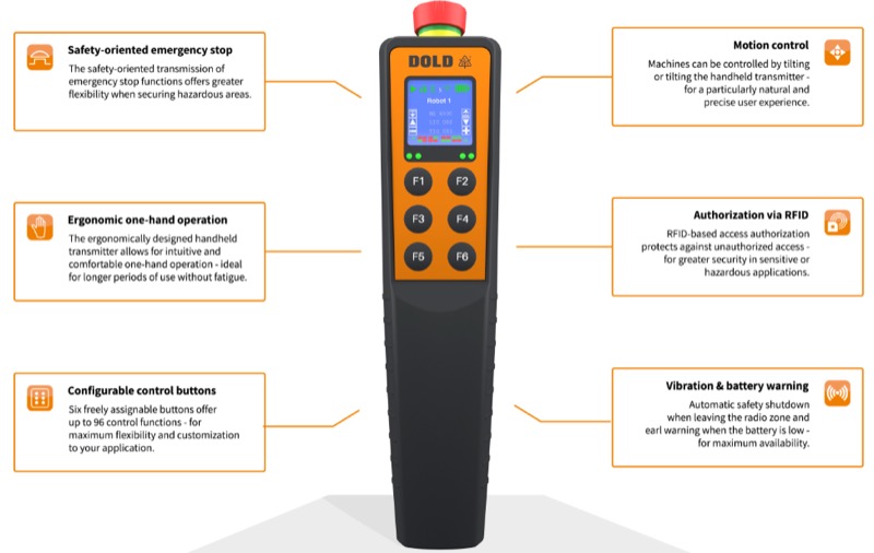

The RE 6900 system is built around a wireless handheld transmitter that can be configured as either a wireless emergency stop or a wireless enabling switch. Both versions communicate with a radio-controlled safety module to execute safety-related shutdowns or enable commands.
Dold’s RE 6900 with emergency stop.
Dold’s RE 6900 with emergency stop. Image used courtesy of Dold
The RE 6900 handheld device allows operators to trigger a safety shutdown from a distance or from within the cell, which is particularly useful in large machines, conveyor systems, robotic systems, or logistics environments where reaching a fixed emergency stop may take too long. The safety-enabling switch configuration supports safety-oriented operation during setup or maintenance and was designed for robotic cells.
The enabling switch uses a three-stage mechanism. Only the defined center position allows machine movement. Releasing the switch or pressing it fully interrupts motion and triggers a safety shutdown by monitoring unintended movements, aligning with common requirements for safety enabling devices within robotic or automated cells.
RE 6900’s Wireless Communication and Safety Monitoring
The RE 6900 uses two-way wireless communication between the handheld device and the safety module, so the system continuously checks that the connection remains intact. If that link is interrupted, the system defaults to a safe shutdown. It also monitors movement and shock to detect if the device is dropped or handled unexpectedly.
User authentication is supported via RFID, enabling access control at the safety device level. This can help limit operation to authorized personnel during service or setup tasks. On the control side, Dold uses the UH 6900 wireless safety modules to manage both control tasks and safety shutdowns. These modules support different operating modes, such as pair mode and group mode, so they can be set up for a single transmitter or shared across multiple transmitters, depending on how the system is used.

  • RE 6900 with emergency stop, intended for wireless shutdown of machines and systems
  • RE 6900 with an enabling switch, designed for setup, maintenance, and service work in robotic and automated equipment
  • UH 6900 wireless safety module, responsible for processing wireless safety signals
  • UH 6900 MF and UH 6900 GC/GR variants, supporting different pairing and group communication modes.
