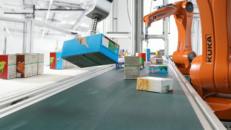

With the KUKA smartPLUG, programmers can use the iiQKA.UI web-based software to program their systems rather than using the typical smartPAD.
With the KUKA smartPLUG, programmers can use the iiQKA.UI web-based software to program their systems rather than using the typical smartPAD. Image used courtesy of KUKA
Featuring a flexible “use your own device” option, iiQKA.OS2 allows users to connect to any tablet by using the KUKA smartPLUG or the familiar KUKA smartPAD. Combined with the web-based iiQKA.UI, operators can intuitively set up and control systems without the need for specialized hardware.
