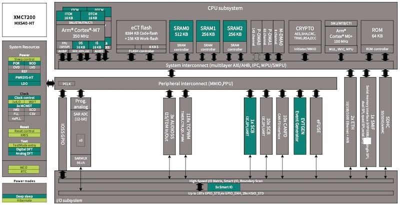

The XMC7000 series (datasheet linked) features single or dual Arm Cortex-M7 cores running up to 350 MHz, with an additional Cortex-M0+ core for auxiliary tasks. It includes up to 8 MB of Flash and 1 MB of RAM. The devices support 2.7 V to 5.5 V operation and function across a -40°C to 125°C temperature range for harsh environments.
Block diagram of the XMC7200
Block diagram of the XMC7200.
Key peripherals include CAN FD, Gigabit Ethernet, and multiple timer modules, targeting applications like motor control, industrial drives, and factory automation. The XMC7000 architecture is built on a low-power 40-nm process technology. Importantly, it also has a cryptographic engine for enhanced hardware security.
