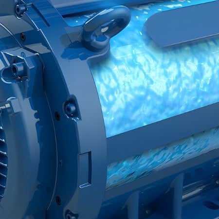

The W22 water-cooled motors remove the fan assembly entirely, eliminating one of the main sources of noise and mechanical wear. The motors feature cast-iron housing that includes smooth contours that prevent dust buildup, and the water jacket is fully sealed to resist contamination from particles or other types of debris that can be found in abrasive conditions, such as mining machinery or tunnel boring systems.
Because heat is removed directly through water circulation, the motor does not pass excess energy into the surrounding environment. This makes it particularly effective in areas where thermal control is critical, such as plastic injection molding, chemical processing operations, and even data centers.
Close-up cut out of the W22’s sealed water jacket, designed to maintain consistent cooling performance in harsh environments
Close-up cut out of the W22’s sealed water jacket, designed to maintain consistent cooling performance in harsh environments. Image (modified) used courtesy of WEG

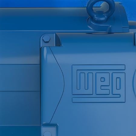

WEG’s standard paint carries C4 protection against high corrosivity
WEG’s standard paint carries C4 protection against high corrosivity. Image (modified) used courtesy of WEG
