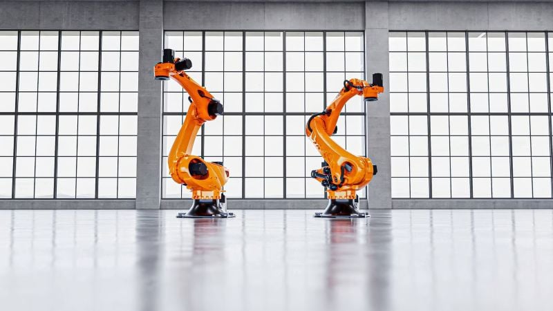

KUKA’s KR FORTEC PA and KR FORTEC ultra PA industrial robot lines are designed for heavy-duty palletizing applications.
KUKA’s KR FORTEC PA and KR FORTEC ultra PA industrial robot lines are designed for heavy-duty palletizing applications. Image used courtesy of KUKA

The KR FORTEC PA 340 and 470 palletizing robots
The KR FORTEC PA 340 and 470 palletizing robots. Image used courtesy of KUKA

The KR FORTEC ultra PA 550 and 800 palletizing robots.
The KR FORTEC ultra PA 550 and 800 palletizing robots. Image used courtesy of KUKA
