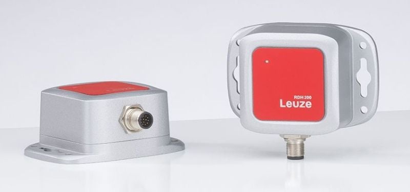

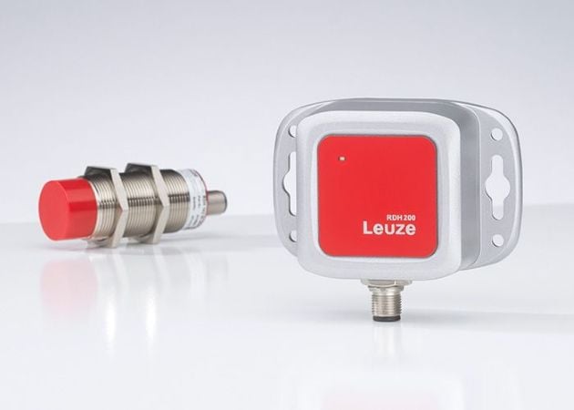

The RDH 100 (left) and 200 series RFID readers from Leuze
The RDH 100 (left) and 200 series RFID readers from Leuze. Image used courtesy of Leuze

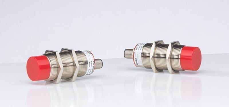

RDH 100 Series
When your application requires a compact, rugged solution for reading RFID tags, Leuze’s new RDH 100 series might be what you are looking for. The RDH 100 series is a compact cylindrical RFID reader capable of reading tags up to 60 mm away. It features a diameter of 30 mm and can be purchased with a metal sleeve. The reader is IP67-rated and has an operating temperature of -32 to 60 °C, which allows it to be used in harsh environments.
The RDH 100 features a compact 30 mm diameter for use in tight spaces
The RDH 100 features a compact 30 mm diameter for use in tight spaces. Image used courtesy of Leuze
RDH 200 Series With NFC
When your application requires a little more range, Leuze’s new RDH 200 series has options with reading ranges out to 100 mm. The RDH 200 uses high-frequency radio waves to support the longer reading ranges while still boasting a compact size of 68 x 68 x 42 mm. The metal housing of the RDH 200 consists of mounting features that allow the RDH 200 to be mounted to virtually any surface, including metallic surfaces.
Near Field Communication (NFC) Functionality
If your application requires a little more wireless transfer of data, the RDH 200 has NFC functionality. NFC is used in today’s smartphones for wireless payment, Bluetooth connection, and opening hotel doors. It can also be used in a machining center to identify fixtures for specific machines or to authenticate personnel. With the RDH 200, NFC enables authentication or data transfer from the NFC tag to the control system.
The RDH 200 features NFC functionality for authentication via tags
The RDH 200 features NFC functionality for authentication via tags. Image used courtesy of Leuze
