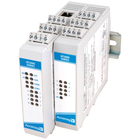

Acromag has added the NT2140 discrete AC input modules to its BusWorks NT series, offering six individually isolated AC optocoupler inputs to monitor 120 V or 240 V AC on/off statuses. Designed for integration into Ethernet-based control systems, the NT2140 communicates over Modbus TCP/IP, EtherNet/IP, and PROFINET. It also includes IIoT-ready protocols like OPC UA and MQTT. With this expansion, engineers gain a flexible way to monitor electrical state changes across a wide range of equipment, including pumps, motors, limit switches, and relays.
AC Status Monitoring Over Ethernet
The NT2140 is purpose-built to monitor field equipment's on/off status through direct AC voltage sensing. Each of its six channels can detect whether 120 V or 240 V AC is present, making it suitable for tracking powered states in motors, pumps, push buttons, and other switchgear. It also includes two bidirectional DC logic I/O channels for monitoring or controlling devices operating between TTL and 0-32 V logic levels.
Modules can be configured via any standard web browser, and dual RJ45 ports support daisy-chaining multiple devices for streamlined network integration. Each channel is optically isolated, which enhances electrical safety and noise immunity in high-interference environments.

The NT2140 is just one component in a modular system. Up to three NTX expansion modules can be added to a single NTE Ethernet module using an internal DIN rail bus. This allows up to 24 AC input channels, or a combination of analog, temperature, and discrete I/O types, to be managed under a single IP address. This flexibility is especially valuable in distributed control applications, from wastewater plants to oil and gas skids.
