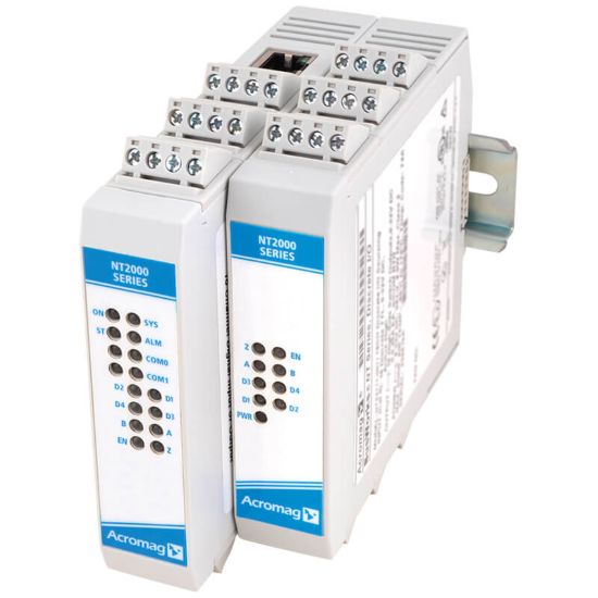

Acromag has recently expanded its BusWork NT series with the introduction of the NT2710 module. This module is a stepper motor controller that enables remote motion control via Ethernet protocols, including PROFINET, EtherNet/IP, and Modbus/TCP. The NT2710 can work with various control systems, including PCs, PACs, and PLCs. It is designed to offer precise motion control and native IIoT capabilities alongside modular I/O expansion options.
Acromag’s NT2710 stepper motor controller expands the company’s family of Ethernet remote I/O modules
Acromag’s NT2710 stepper motor controller expands the company’s family of Ethernet remote I/O modules. Image used courtesy of Acromag

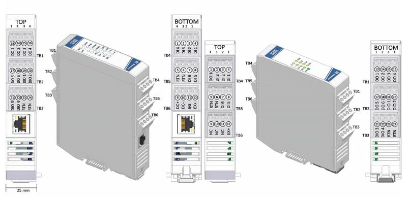

Acromag's new NT2710 stepper motor controller module offers six outputs for pulse trains, which work to control the step and direction signals of stepper motor drivers. Additionally, it includes six encoder inputs, allowing for enhanced flexibility in motion profiling and control over the motor's speed, direction, and position.
Users can program the control module with triangular, linear, or trapezoidal acceleration/deceleration profiles to perform a range of motion tasks, ensuring smooth motion with minimal mechanical stress. The new module also has functions for motion control, such as a high-resolution timer, and features four general-purpose I/O channels that can be used for basic control.
The NT2710 module features six pulse train outputs, six encoder inputs, and four general-purpose digital I/O channels
The NT2710 module features six pulse train outputs, six encoder inputs, and four general-purpose digital I/O channels. Image used courtesy of Acromag

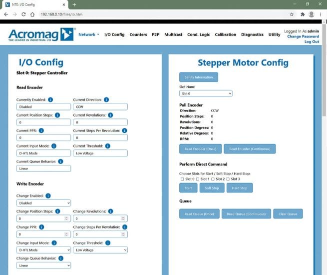

The NT2710 module supports multi-protocol communication, enabling seamless integration with existing control systems via Ethernet/IP, Modbus/TCP, and PROFINET. These protocols, accessible through any standard web browser, offer flexibility in terms of communication options for sending commands to the stepper motor control. Additionally, the new module supports advanced IIoT capabilities through MQTT client, OPC UA server, and RESTful API.
The NT2710 module, with its multi-protocol capabilities, enables seamless remote control, facilitating secure cloud-based data exchange and monitoring. A built-in conditional logic allows the creation of custom rules through the web using IF/THEN/ELSE logic, without requiring complex programming, and defines up to 64 logic conditions per module.
Users can configure the NT2710 module over a web browser
Users can configure the NT2710 module over a web browser. Image used courtesy of Acromag
