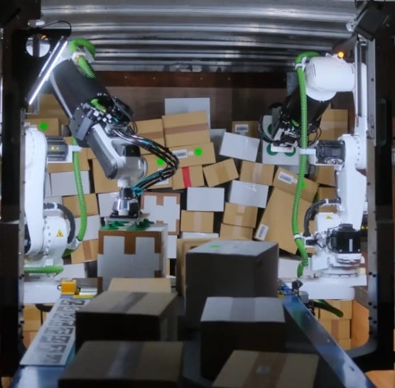

Package handling in and out of trucks is a major challenge.
Package handling in and out of trucks is a major challenge. Image used courtesy of Kawasaki Robotics

The Mech is possibly the world’s first smart arm robot for moving packages. While there are plenty of robots that can be commanded to move a particular item with human control, or lots of identical items, fully automated, there has yet to be a robot quite like the Mech. It is capable of sizing up packages and unloading or loading them much like a human worker. In fact, one human worker can pilot ten Mechs, drastically increasing the package handling throughput in any facility.
The Mech: Two AI-controlled robotic arms on a mobile base.
The Mech: Two AI-controlled robotic arms on a mobile base. Image used courtesy of Dexterity
Advanced package handling is made possible through the use of Dexterity’s Physical AI software. This software runs on an onboard supercomputer and uses the input from 16 cameras. Machine vision and touch sensors assess each package for optimal placement. Also, the software can be updated easily, meaning it is easy to teach the robot new tricks.
The two arms allow for a full eight degrees of freedom, meaning packages can be manipulated in the tight spaces. Furthermore, the arms are mounted on a mobile base so that the robot can move as needed or adjust its stance for heavier packages. In terms of lifting capability, the Mech can lift up to 65 lbs with each arm (130 lbs total) and reach up to eight feet in the air.
