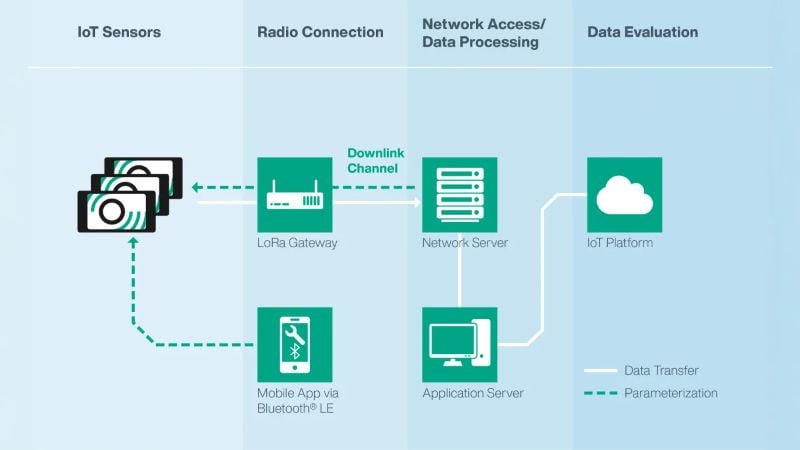

The WILSEN.node utilizes a LoRaWAN network to enable signal transmission over long distances, bringing IoT capabilities to existing systems
The WILSEN.node utilizes a LoRaWAN network to enable signal transmission over long distances, bringing IoT capabilities to existing systems. Image used courtesy of Pepperl+Fuchs
