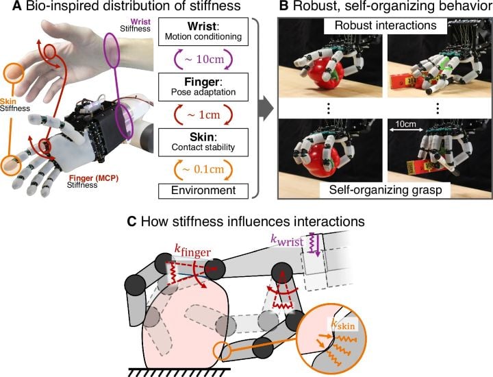

The innovative ADAPT hand features 20 joints, and unlike a conventional robotic hand that requires motor activation for each joint, the new robotic hand is equipped with 12 motors located in the wrist. The hand simplifies control by focusing on four key motion points, allowing it to adjust to various objects and positions with ease. This is made possible with its spring-loaded joints, compliant robot wrist, and soft silicon skin.

Designed to mimic the mechanical characteristics of a human hand, the ADAPT hand features configurable stiffness in the skin, fingers, and wrist, allowing centimeter-scale adaptive motion and smooth object engagement. The hand employs open-loop control, eliminating the need for feedback from sensors or mapping of the surroundings to function.

Tests conducted by the CREATE Lab engineering team of the ADAPT hand involved picking up objects from a tabletop. Based on the object orientation and size, the hand adjusted the grip style, using a finger grip for smaller items and a power grip for larger ones. Out of 24 items, the hand demonstrated a 68% match in grasps, successfully handling 17 items, and achieved a 93% success rate overall when attempting to grasp them three times with different placements along its path.
