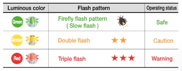

The CAN communication control model is compatible with the SAE J1939 protocol, making it suitable for construction machinery. It supports 13 flash patterns and four dimming levels, all configurable through CAN communication, and allows for monitoring of the light color and flash pattern. It also features automatic detection and connection at 250kbps or 500kbps. In contrast, the Standard Voltage Control model is a non-communication type that uses conventional voltage applications. It has three fixed flash patterns optimized for red, amber, and green status indications but does not support monitoring or acquiring the operating status. With this level of adaptability, the GL10 is well-suited to both new installations and retrofitting into existing systems.
Three pre-configured flash patterns are available in voltage-controlled models.
Three pre-configured flash patterns are available in voltage-controlled models. Image used courtesy of PATLITE
