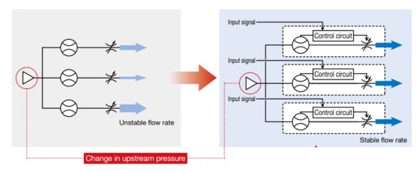

FC3W Series Flow Controller for Water
When upstream water pressure fluctuates, maintaining a steady flow rate can be tricky with old-school manual valves. SMC’s FC3W series brings a modern solution with stepless, electronically controlled flow adjustment. With a rated flow control range expanded to 5–40 L/min and ±5% accuracy, the FC3W delivers reliable performance even under shifting pressures. Adding IO-Link connectivity opens a door to remote diagnostics, status monitoring, and valve positioning. In other words, engineers can identify and address issues before they become failures, a significant advantage for applications such as printer roller cooling or semiconductor wafer production.
The FC3W provides stability when upstream pressure changes.
The FC3W provides stability when upstream pressure changes. Image used courtesy of SMC

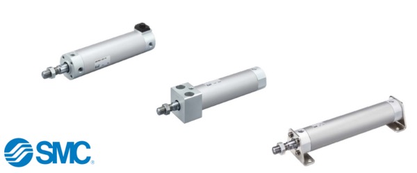

CG1 Series Air Cylinder Upgrades
SMC’s CG1 Series air cylinders are getting several important new variations. With single-acting, direct-mount, and end-lock types now available, the CG1 line gains more flexibility for tighter design spaces or special safety requirements. One helpful touch: a cylinder with rod end brackets is now standardized, eliminating the hassle of separate bracket orders. Additionally, piping can be connected at every 90-degree angle, allowing designers to place cylinders where they’re most effective. Whether customers choose a double-acting, single-acting, or end-lock variant, the CG1’s modular design ensures compatibility with previous models, avoiding costly redesigns.
The CG1 series air cylinders gain several new updates.
The CG1 series air cylinders gain several new updates. Image used courtesy of SMC

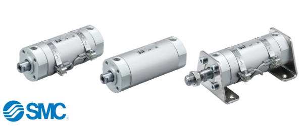

CG3 Series Compact Air Cylinder
Space constraints continue to challenge factory layouts, and the CG3 Series addresses this exact challenge. Compared to its CG1 sibling, the CG3 trims up to 51 mm off the overall length and cuts weight by as much as 24% while offering the same functional reliability. Available with either male or female thread options and equipped for auto-switching, the CG3 makes installation easier in tight spots. Bore sizes range from 20 mm to 100 mm, allowing engineers to size the cylinder to their specific application without compromising speed or force. The CG3 helps designers achieve a smaller footprint, keeping machines lighter and more efficient.
The CG3 series air cylinders are a compact option for tight spaces.
The CG3 series air cylinders are a compact option for tight spaces. Image used courtesy of SMC
