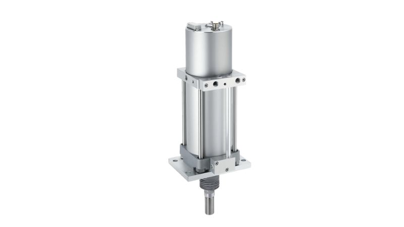

SMC’s IN-777 series air servo cylinder features a positioning repeatability of ±0.5 mm
SMC’s IN-777 series air servo cylinder features a positioning repeatability of ±0.5 mm. Image used courtesy of SMC
Air Servo Cylinders
When your application requires pneumatic technology but also requires positioning control and feedback, an air servo cylinder might be your best choice. SMC’s IN-777 series air servo cylinders consist of a valve unit, a pneumatic cylinder, a controller assembly, and a position sensor unit. The valve unit contains a servo-driven proportional valve that will control the amount and speed of air pressure entering the cylinder. This level of control allows the system to control the speed and force of the cylinder. The position sensor reports back to the control system to close the feedback loop.
The IN-777 has a built-in self-diagnosis function indicated by the LED display on top of the controller assembly. Fail-safe ports are provided if an emergency stop has occurred and the cylinder has stopped partway through its motion. The fail-safe ports allow technicians to manually move the cylinder without power or main air supply.
SMC has updated the IN-777 series to now include FOUNDATION Fieldbus communication.
