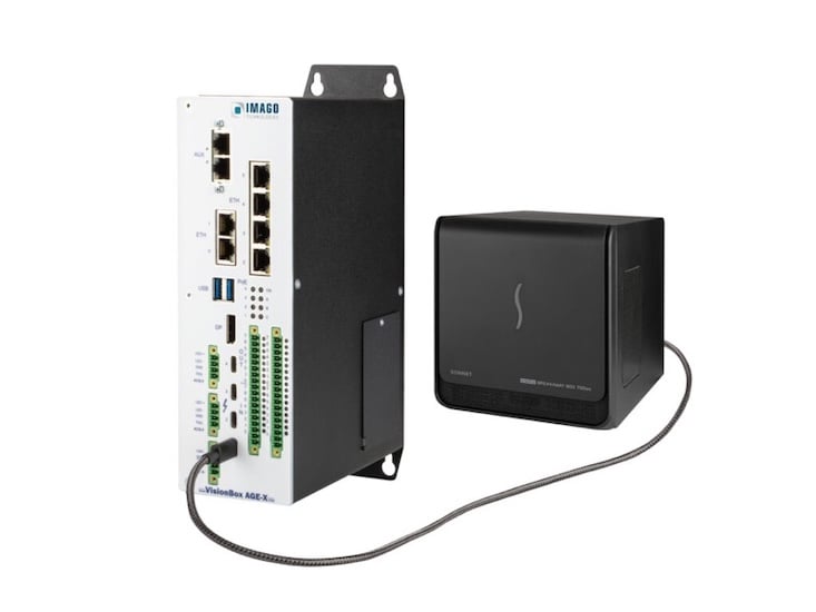

Industrial vision demands are growing, from faster package tracking to defect detection on dense circuit boards. IMAGO Technologies addresses this with the Vision Box AGE-X6, a compact industrial PC built around Intel’s 14th-generation embedded processors and four USB4 interfaces. Instead of replacing entire systems, machine builders can scale performance by adding GPUs, cameras, or storage on demand. This modular approach preserves existing certifications, software, and layouts, offering a flexible, cost-effective way to keep pace with evolving vision requirements.
The Vision Box AGE-X6 lets factories plug in more power with USB4, making adding more GPUs or cameras easier.
The Vision Box AGE-X6 lets factories plug in more power with USB4, making adding more GPUs or cameras easier. Image used courtesy of IMAGO

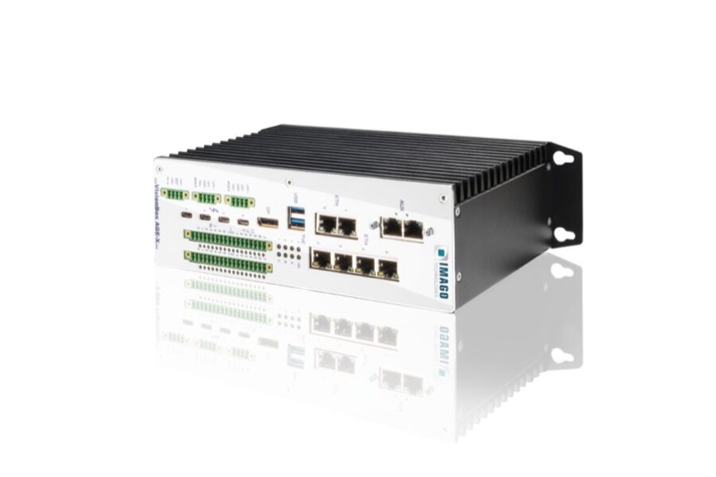

IMAGO Technologies’ Vision Box AGE-X6 is a compact industrial PC designed around modular expansion. At its core is Intel’s latest 14th-generation embedded processor platform, but what makes the system stand out are its four USB4 interfaces, each offering up to 40 Gbit/s. Instead of swapping out an entire PC, users can boost performance by attaching external GPUs, high-speed storage, or high-performance cameras without disturbing the base system.

The AGE-X6 is designed for a variety of factory settings. In logistics, it can keep up with fast-moving packages and still read codes even when labels aren’t placed consistently. In electronics production, it has the precision to catch tiny defects on crowded circuit boards without slowing the line down. In pharmaceuticals and medical technology, it minimizes re-certification cycles since the underlying base system remains untouched, even as new vision demands arise. This versatility makes it especially useful for integrators and machine builders, who can now run various product lines through a single system.
USB4 lets the AGE-X6 scale fast, handling AI, analytics, and cameras.
USB4 lets the AGE-X6 scale fast, handling AI, analytics, and cameras. Image used courtesy of IMAGO

At 40 Gbit/s per channel, it can quickly move large volumes of image data to support deep learning models, real-time analytics, or simultaneous camera streams. External GPUs connected via USB4 turn the compact, fanless box into a scalable powerhouse, ready to grow with new vision technologies. Machine builders can scale incrementally instead of forcing early adoption of fixed, high-cost systems, keeping capital costs under control while staying ahead of industry requirements.
