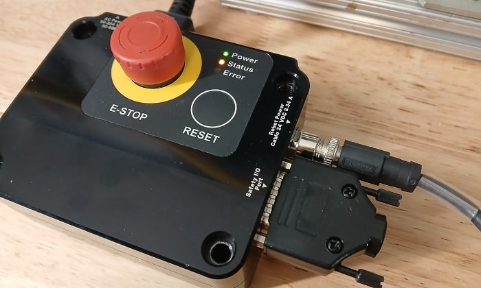

In the Meca500, control works differently. The robot isn't handling any I/O data; it’s not paused waiting for a specific input signal before advancing through the program, and it doesn’t calculate new positions. All I/O logic is handled on the external PLC, then at the proper time, the robot is commanded to execute one of its motion programs.
 Figure 2. The robot I/O block - only for safety I/O.
What, then, should happen if there is a need for positional calculations or a delay while waiting for an input signal? The answer is that two methods are provided for commanding the robot.

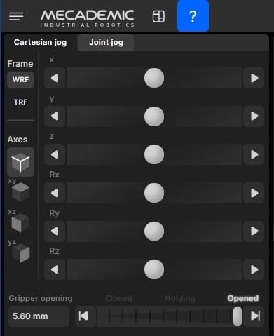

We must be certain of the target positions before writing motion commands. For beginners, use the jogging interface to move the robot very close to the target. Jogging will provide the assurance that you have correctly evaluated the directions of the x, y, and z axes. Guessing on a Cartesian point and omitting a (-) sign in a coordinate can be disastrous.
 Figure 4. Jogging commands.
Once the point is known, the motion command can be inserted. Most often, this is a MoveJoints or MovePose, since those will move to the point with the greatest speed. They won’t always follow a perfectly straight line, so don't use them when carefully gripping an object with little room for error.
The main difference between MoveJoints and MovePose is the information about the target.
  • The Joints command requires you to know the angle of each of the 6 joints, and so the position of the TCP will be the result of all of those joints.
  • The Pose command requires you to enter the x, y, and z coordinates, along with the angle of rotation around x, y, and z. The controller will calculate the required angle of each joint.

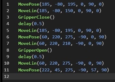

For our program, the robot will approach a pick point, reach down to grip an object, and then place it in a nearby location. The sequence, in plain English, looks like this:
  1. Quickly move above the pick point
  2. Carefully reach down
  3. Grab the object
  4. Carefully lift straight up
  5. Quickly move to a position about the set-down point
  6. Carefully reach down
  7. Release the object
  8. Carefully move straight up
  9. Quickly move to a neutral position that doesn’t waste time when the program begins again
The use of carefully denotes that we will use MoveLin, and quickly indicates that we may use MovePose or MoveJoints. I’ll use MovePose so that all points are in x,y,z,ɑ,β,γ format.
The only other command to explain is the gripper motion. We might use GripperOpen and GripperClose, which behave exactly as their names suggest. GripperMove is an alternative that gives us more control over the gripper position in mm. For this simple program, we’ll use GripperClose and GripperOpen.
 Figure 5. Complete program.
//1) Grip position near the front of the robot
MovePose(185, -80, 195, 0, 90, 0)
//2)
MoveLin(185, -80, 150, 0, 90, 0)
//3) The delay allows the robot to remain in place until the gripper is securely closed.
GripperClose()
Delay(0.5)
//4)
MoveLin(185, -80, 195, 0, 90, 0)
//5) Release position near the left side of the robot
MovePose(60, 220, 275, -90, 0, 90)
//6)
MoveLin(60, 220, 210, -90, 0, 90)
//7) Remember the delay, or the robot will begin leaving before the gripper is open
GripperOpen()
Delay(0.5)
//8)
MoveLin(60, 220, 275, -90, 0, 90)
//9) Somewhat random intermediate position
MovePose(222, 45, 275, -90, 57, 90)
