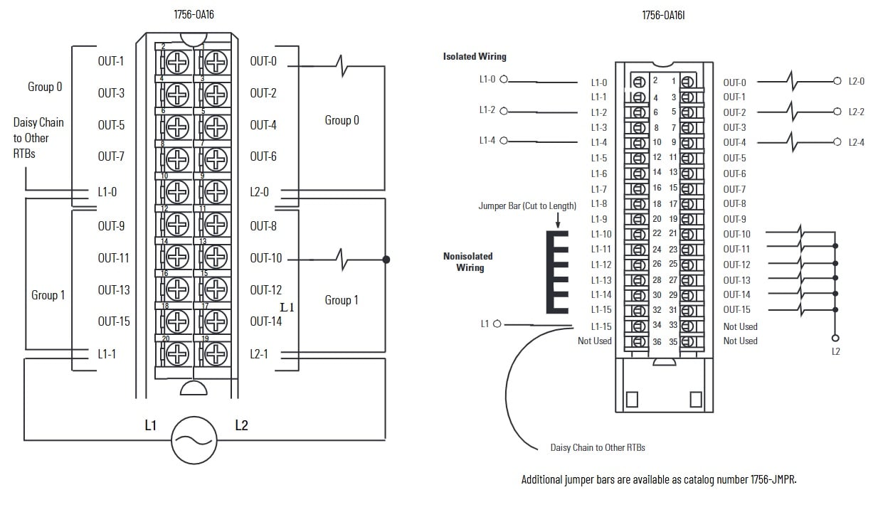

Let’s have a look at a specific example, with Rockwell’s 1756-OA16 (commoned AC output) versus 1756-OA16I (individually isolated). In the common version, outputs share a field reference. In the isolated version, each output channel is electrically separated from the others.
 Figure 2. The difference between a common output card (left) and an output card with isolated terminals (right).
Figure 2. The difference between a common output card (left) and an output card with isolated terminals (right). Images (excerpts from manual) used courtesy of Rockwell Automation
As noted in the manufacturer’s documentation, you can optionally turn the isolated module into a common module with jumpers, but you have the option of using each channel individually.
When are common outputs fine?
  • If all loads can safely share the same power supply
  • They share the same ground reference
  • The field wiring is relatively short
  • The environment has low transient noise
When should you consider isolated outputs?
  • If the loads are powered from different supplies
  • If devices are located in separate panels with different ground potentials
  • In the presence of high-energy inductive loads
  • Any situation in which a short on one channel must not affect the others
Isolation contains the faults to a single circuit. So a short or transient on one isolated channel is less likely to disturb adjacent channels. However, in panels that may have mixed voltages, containment can prevent trips or module damage.

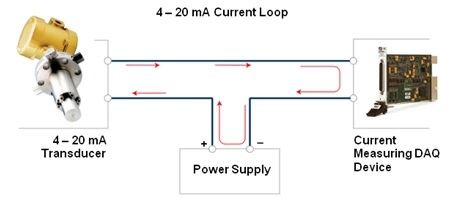

4-20 mA Loops
A 4-20 mA loop may be powered by a field supply located hundreds of feet away. If the PLC analog input shares a common reference with other channels, differences in ground potential can introduce common-mode voltage or ground loop currents.
 Figure 3. A basic ground loop formation in a 4–20 mA system.
Figure 3. A basic ground loop formation in a 4–20 mA system. Image used courtesy of NI
An isolated analog input breaks the loop at the module boundary, preventing unwanted current flow and preserving signal accuracy.
