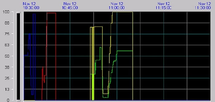

Recorder
A device that can store data allows us to observe the current state of the variable and how it behaved in the past. A recorder provides us with the history of the variable.
Instrumentation recorder
Figure 3. A display showing how measurements have changed over time.

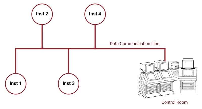

Digital Devices:
  • Multiple instruments can use a single cable
  • Transmission of multiple values for each instrument (process variables, calibration, diagnostics, range)
  • Distance: approximately 1900 m without a repeater
  • Data capacity is influenced by the mode of transmission (cable, fiber optic, wireless)
Digital measurement on a communication line
Figure 8. Digital transmitters.

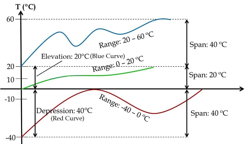

General Sensor Specifications
Range: The region between the limits within which a variable is measured. It indicates the minimum and maximum values that limit the region. The range is expressed with two numbers, e.g., 10 to 20 °C, 10 to 150 V, 0 to 100%
Span: Calculated as the maximum value of the range minus the minimum value of the range. Span is expressed with a single number in process units, e.g., 120 °C, 30 V, 150 liters per second.
Elevation: If the lower limit of the range is a positive value, this lower limit is the elevation. Example: If the range is 50 °C to 200 °C, we can say that the elevation is 50 °C or 33.3% of the span.
Depression (also referred to as suppression): If the lower limit of the range is negative, the absolute value of this lower limit is the depression. Example: If the range is -10 °C to 80 °C, we can say that the depression is 10 °C or 11.1% of the span.
Overrange: When a device is calibrated to operate within a certain range but may be subjected to values above or below that range, then it requires a protection mechanism to prevent damage to the instrument or to prevent the indicator from exceeding its upper or lower limit. When the measured values are above the maximum value, we have positive overrange. When the measured values are below the minimum value, we have negative overrange.
Examples of various instrumentation curves
Figure 9. Examples of range, span, elevation, and depression.
