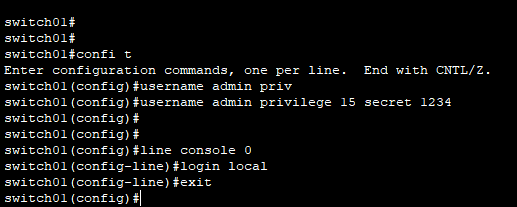

As a field engineer or SCADA engineer trying to access the network switch (locally or remotely), we must pass the authentication and authorization security protocols to enter the device setup. The username/password conditions can be applied whether the service engineer tries to connect through the console port or SSH. The authentication credentials can be saved locally in the switch or on an external server. The following CLI commands are used to set the username/password for the switch.
First, enter the global configuration mode (type “config t”), and issue the following commands as shown in Figure 2.
 Figure 2. Commands to set username and password for console port authentication.
Figure 2. Commands to set username and password for console port authentication. Image used courtesy of the author
In this example, ‘admin’ is the username and ‘1234’ is the secret (password). The “line console 0” means physical console port, which is the primary interface for initial switch setup for a new switch. The locally configured username and password is set for the authentication. When an end user attempts to log in via the console port, in order to see the current configurations in the switch, issuing the command “running-config” will display the settings applied to the device.

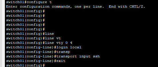

Next, to configure the SSH protocol for remote access and for authentication, use the locally stored credentials. The command “transport input ssh” is used to accept the SSH connection on the specified VTY lines. The VTY 0 4 means that the device allows five simultaneous remote connections (0 to 4), and the switch will reject remote connections other than SSH.
 Figure 4. SSH protocol connection for 4x concurrent remote connections.
Figure 4. SSH protocol connection for 4x concurrent remote connections. Image used courtesy of the author

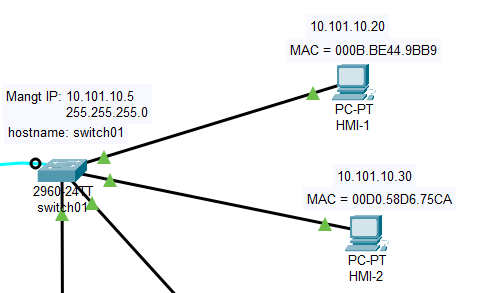

The concept of MAC binding is that each port of the switch is bound with the hardware connection of one particular PC, HMI, server, or other device.
 Figure 7. MAC addresses of devices are bound to switch ports.
Figure 7. MAC addresses of devices are bound to switch ports. Image used courtesy of the author

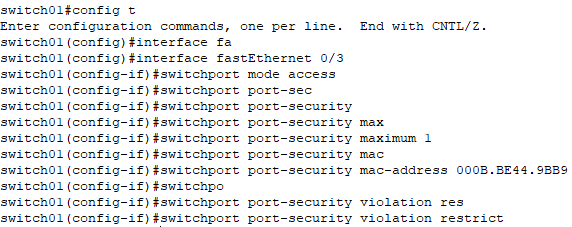

Below, we will examine the steps to perform the binding of the MAC addresses of HMI-1 and HMI-2 to ports# 3 and 4 of the switch. The advantage is that the switch port will terminate the connections if new devices with different MAC addresses try to connect to these ports.
 Figure 8. Binding MAC addresses to switch ports.
Figure 8. Binding MAC addresses to switch ports. Image used courtesy of the author
