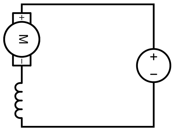

Series Wound Motors
A series wound motor is a type of electric motor where the field windings are connected in series with the armature windings, allowing the field coils to receive the full current from the armature; see the figure below. This configuration is akin to how Christmas tree lights are wired together.
The advantage of this setup is that it creates a strong relationship between the field current and the torque produced, meaning that torque is directly proportional to the current over the entire operational range. Consequently, series wound motors can generate significantly higher electromagnetic torque, making them particularly effective for applications that require high starting torque, such as industrial machinery or heavy lifting operations, like cranes.
 Figure 4. Circuit diagram of a series wound motor.
However, series wound motors are not without disadvantages. The lower resistance and higher torque on startup can lead to a higher current if the top speed is not quickly reached. Maintaining a long startup time can lead to motor overheating.

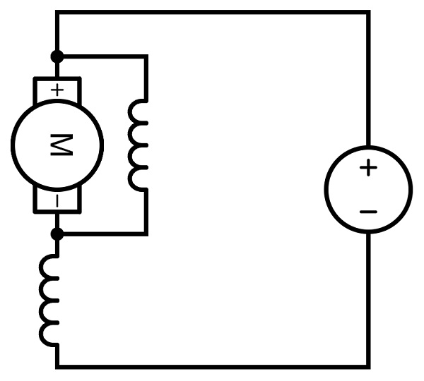

Series + Shunt Windings = Compound Wound Motor
A compound wound DC motor is essentially a shunt wound and series wound motor combined into one. This design allows it to combine the benefits of high starting torque from series wound motors and good speed regulation from shunt wound motors. Compound wound motors are categorized into long-shunt and short-shunt types, which depend on whether the shunt wiring is across both the armature and series field coil (long shunt) or if the shunt wiring is only parallel to the armature winding (short shunt). Their ability to manage varying loads while maintaining a relatively stable speed makes them suitable for various applications, including large industrial machinery like presses and rolling mills, as well as conveyors, agitators, elevators, machine tools, and reciprocating pumps.
 Figure 6. A compound motor is essentially a hybrid of a series and shunt motor.
Despite their advantages, compound wound DC motors also have some notable disadvantages.
Their starting torque is not as high as that of purely series DC motors, and their speed regulation is less effective than that of shunt DC motors. Moreover, the complexity of their design can lead to increased maintenance requirements. In some scenarios, different types of compounding, such as differential compounding, may limit their practical applications by reducing overall flux and performance, making them less favorable for certain uses when compared to series or shunt wound motors.
