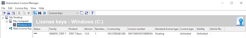

Software Licensing Process
The options for software are almost as varied as the number of PLCs on the market. Paid software is always available in multiple tiers, usually starting with a low-cost or free entry level with limited command sets or program size. There may also be a significant up-front cost difference between an annual subscription and a one-time permanent license. Many engineers prefer the permanent license, but they consider whether software upgrades are included. That might not be a problem in various projects.
 Figure 2. Permanent licenses can be useful for longevity, but lack periodic updates.
Another method to consider is how the license is acquired. Some license keys are provided in a hard copy or a USB dongle, while others are supplied by a local distributor. Some one-time licenses are available digitally (such as an email) at the time of purchase.
There are many examples of highly capable software that have neither a license nor a purchasing cost. This can be extremely helpful for small projects or for personal learning, but they can’t really be used without first purchasing the PLC hardware.

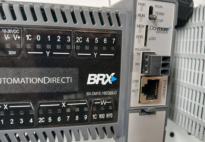

Network Connections
It’s hard to find a modern PLC that doesn't have some form of network support. But this is a point of caution: the shape of the port does not always define that supported kinds of networks. The most familiar port is the 8-pin RJ45. This most likely supports Ethernet, PROFINET, or EtherCAT. In rare cases, a port is multi-protocol, meaning the protocol can be selected in the software.
You absolutely need to know your network before selecting the PLC. Will you require Ethernet support? Modbus TCP devices? EtherCAT motion? If you require two or more protocols, ensure the PLC supports add-on communication modules. I strongly recommend, do NOT purchase the PLC without carefully assessing your network needs. This will lead to significant extra costs for gateway adapters and headaches.
 Figure 4. This PLC provides access to Ethernet and RS-232/485 networks.

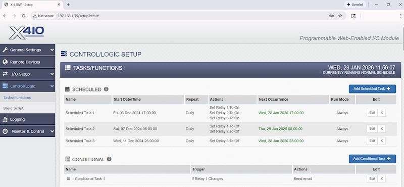

Web Server Access
The web server feature isn’t necessarily a make-or-break feature for a PLC, but it may be a deciding factor when comparing two options.
Basically, a web server is a program stored on the PLC, not on your computer. But, just like regular programs, not all web servers are alike. Sometimes a web server allows some limited programming access. Sometimes, the web server allows configuring IP addresses and other system information. Sometimes, the web server is used to observe I/O states and alarms for troubleshooting.
The web server is accessed by connecting it to your computer via a network cable. Open your favorite web browser and enter the PLC's IP address.
If you see that a web server is featured on a PLC, be sure to find out what you can accomplish with it. You may be pleasantly surprised with what you can assess without extra HMI hardware.
 Figure 5. This web server allows some basic control logic programming.
